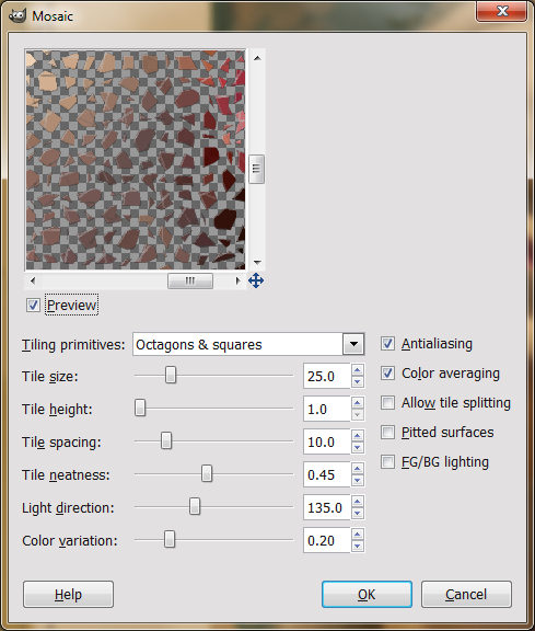

First choose a target. Then right click on the layer dialoge and add alpha Channel (this is important). Now run GIMP's Mosaic filter with the following settings:

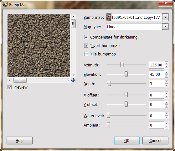

On the top layer Gaussean blur with the default 5 setting and merge all layers. Pretty much we are done. Now for the grout step. Choose a grainy texture and then create a new base layer with that texture. Then, on the base layer, run bumpmap with default settings as shown below:

but the mosaic filter seems to be missing options from lyle's description
on mine,it shows either squares or octagons,not both together and no light or color directions
