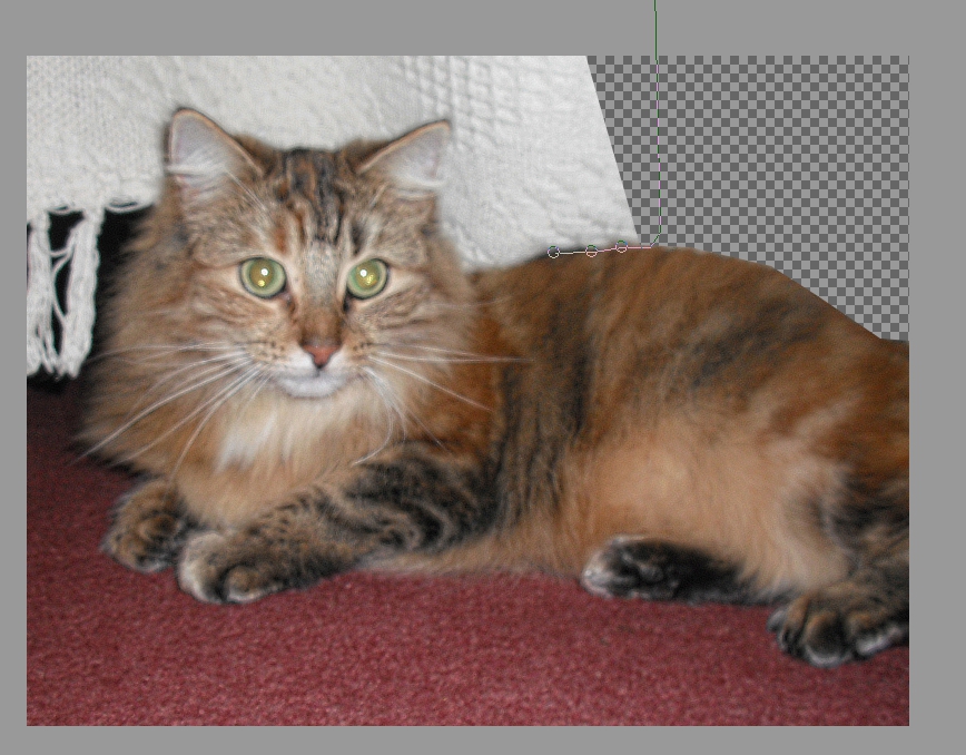

Open photo, add alpha channel and remove background.
Duplicate layer twice and make top layer invisible.
Remove alpha channel from middle layer.
Filters/edge-detect/difference of gaussians followed by colour/levels and adjust detail.
Colour/threshold and adjust detail.
Make top layer visible and colour/threshold and adjust detail.
Change top layer mode to multiply and merge with middle layer.
On bottom layer choose alpha to selection and select top layer.
Select/invert followed by edit/cut and change layer mode to value.
Make any colour adjustments to bottom layer then merge without flattening.
Image/autocrop then save as PNG.

Very nice, Is this your cat Erisian?
What does removing the alpha channel from the middle layer do?
 Post subject: Re: Make your own clipart
PostPosted: Sun Mar 25, 2012 5:50 pm  (#3)
No, it's my friend's. If you scratch his back, he'll groom you - he's adorable! Difference of gaussians doesn't seem to work on a layer with an alpha channel, Molly - I don't know why.

"Open photo, add alpha channel and remove background.
Make top layer visible and colour/threshold and adjust detail."
how do I remove background? and what kind of detail adjustment i need to do?
I am such a noobie still!!!! lol
Please help
Thank You
PostPosted: Sun Mar 25, 2012 9:14 pm  (#7)
Remove background with selection of your choice and cut or with eraser. Detail adj. move sliders until you are satisfied. These are things that are your choice - sorry if I didn't explain things too well.

so erase background as in show the checkered part around the image i want to keep?
PostPosted: Sun Mar 25, 2012 9:40 pm  (#10)
That's right. You can use the free select tool to plot points around your object if you like.

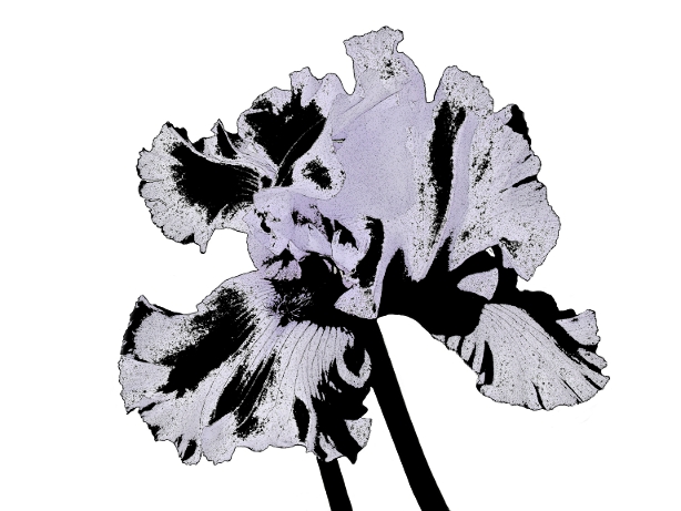

Interesting process. Meesa liking dis!
File comment: original of one of my hybrid Irises
File comment: Clip-art process results
PostPosted: Mon Mar 26, 2012 9:12 am  (#12)
Excellent work. I like the subtlety of the lilac in this.

You don't need to cut away the background at the end - putting the layer on value removes it. Also, instead of threshold on the middle layer, try desaturate.

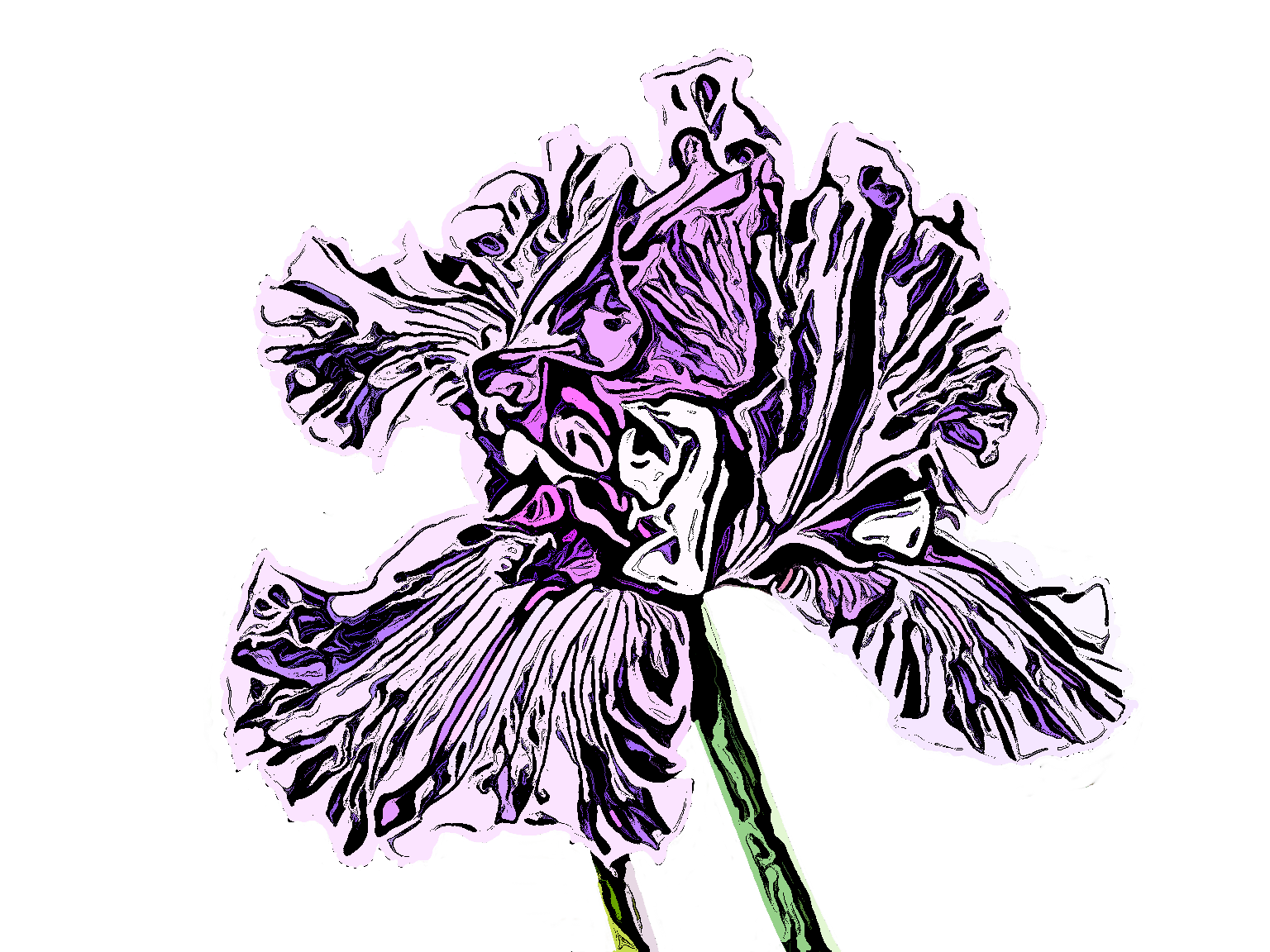

Just as a side note, Old School 8-bit (a G'MIC preset under Deformations) can give you a similar result. :)

G'MIC Paint followed by G'MIC Old School 8-bit and then some color enhancements. :)
