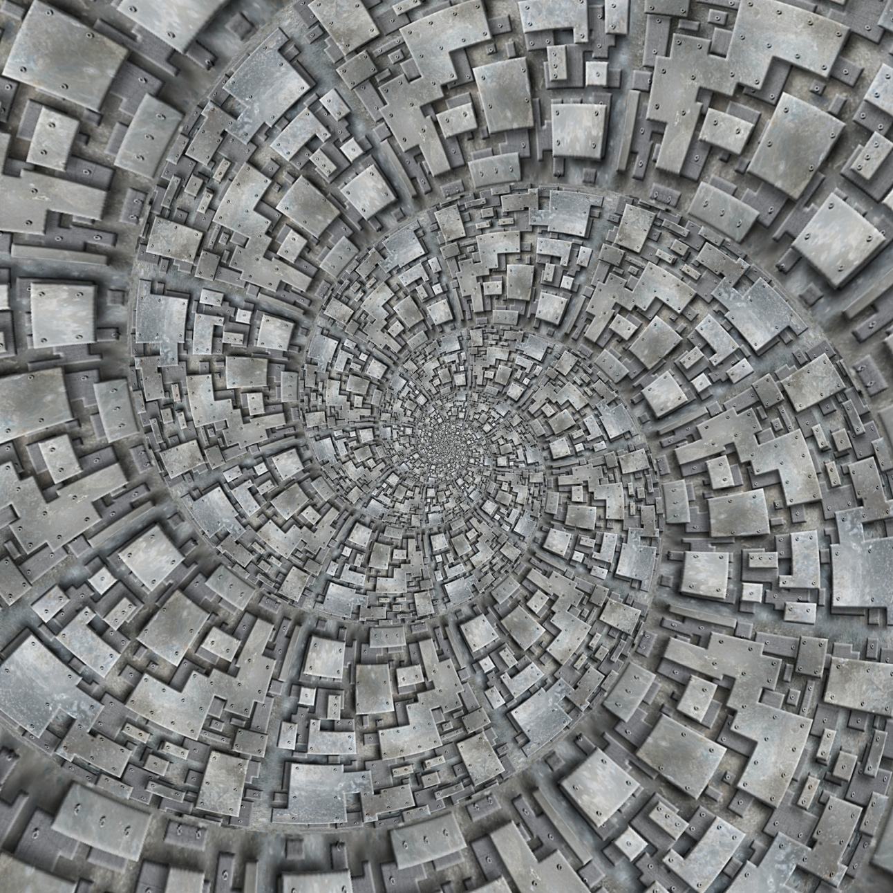

Well, got of my lazy behind and made a more formal tut (instead of handwaving the procedure; lol). I used one of Drac's renders as reference: http://www.flickr.com/photos/63292728@N ... otostream/
Link to tut: http://justpaste.it/resynth_seamless
 Post subject: Re: Using Resynthesizer to create seamless textures.
PostPosted: Wed May 09, 2012 1:08 pm  (#2)
Posts: 12850
Some play with the texture created. :)

Yeah; never tried doing this until now and you are right Erisian; might be a temporary problem at justpasteit. Also, I noticed that I left out some critical steps so I updated the tut (same link). You can try just selecting a full box and try Resynthesizer to make the outer box itself seamless, but I usually get undesireable artifacts doing it this way (even worse with the new version of resysthesizer for whatever reason), so that is way I to the two step process with Resynthesizer. :)

You can thank Draconian for the original target PC. That texture he created is pretty cool and I see a lot of possibilities with it. :)

I like the UFO result too by the way; guess I should share the top view (minus space background). Won't take any of Tux's storage space for this one though. Click for the hirez (png with transparent background). :)
