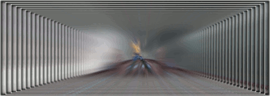

here i used the Tunnel filter (also in "frames and arrays" ) changing only the first parameter

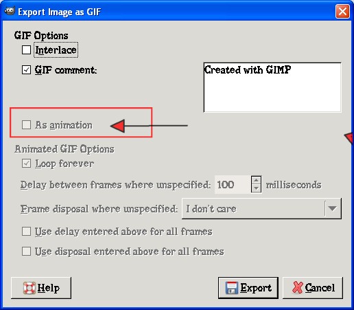

then is easy make a mistake when saving gif please look the dialog:
Note the checkbox " as animation"
maybe was designed by a sadist ,since the as default that is left unchecked
..while the only good reason to save something as gif is to get a animated gif
, so CHECK IT!
So TAKE CARE to check that “save as animation“ box and then click OK

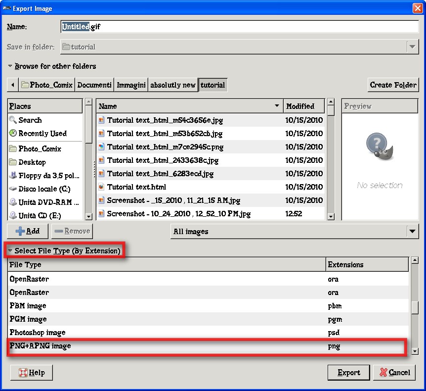

SAVE AS .apng (animated png)
apng offer a much higher quality (but bigger file size) then gif ,and is actually well dispayed by most of the browser (Firefox , Opera Google Crome..even recent version of IE )
the way to call the apng plugin is tricky:
usually nothing has to be done to use the file convertion plugin
NOT in this case :
if you just try to save something as image.apng will pop up a warning about apng be "unknow file type" save will fail and you may think the apng plugin doesn't work
BUT IT WORKS:only you have to expand a almost hidden dropdown list in the save dialog..look here
quite hidden in the lower part of the menu the voice to chose to to successfully save as apng
download http://registry.gimp.org/node/24394

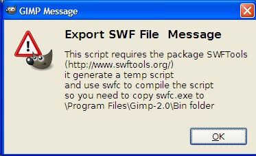

SAVE AS SWF (Flash )
GIMP may export your animation as swf thank to third third party plugin as this
FOR LINUX http://www.registry.gimp.org/node/14983
FOR WINDOWS
for windows there is a similar plugin created by James Huang http://www.box.net/shared/htf97ciy3r
[b] read the author comment
http://www.gimptalk.com/forum/flash-swf-export-python--t41499.html ,because there is something tricky about the saving path (shortly path should have no embedded empty spaces...So in win you should avoid to save" in "document and setting" or any of its subfolders (as "document" and "image ")
but something as C:/SwfVideo would work...then should be not special character (as è, ç ...) and the first letter of the name should be a uppercase ( C:/swfVideo would NOT work...C:/SwfVideo should work )
if you need to contact (or to say thank ) the developer James H go here
http://tw.myblog.yahoo.com/jw!5nbbef.RA ... &next=2237
and yes the page is in japonise but he may well read english

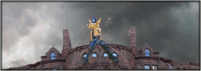

I like the technique. I wish I had the SWF ability, because GIF sucks and PNG is too big and sometimes (like now) doesn't work at all!!!
This image is my sig file on another site, that I animated with G'MIC. Also, it runs like @#$% on IE.

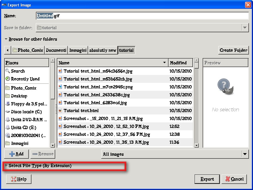

And i forgot to add that is possible also save with much higher quality then with gif as apng (animated png , FF and Opera display them well not sure for IE
and advice that the apng plugin is tricky:

there quite hidden in the lower part of the menu the voice to click on to successfully save as apng

Thanks for your replies, PhotoComix.
The last 5 or 6 frames from G'MIC while I was changing only the width didn't seem to get any smaller so I quit.
The reverse layer stack script came up with two errors so I went to Layers > Stack > Reverse Layer Order after I had duplicated my initial image and saved the duplicate as a separate xcf file.
Then I opened the separate xcf file as layers in my initial layers.

mmhh ..maybe saulgoode didn't update the script because same option was added to gimp by that " Layers > Stack > Reverse Layer Order" new entry.
Thank to point out i will edit again the tut to correct this...a bit later because now my ADSL is agonizing and go to about 20kb/sec ..less then a dial up and this make almost impossible post messages here.
Anyway you are less perplex now? you got the idea about how add new layers without have to close and reload gmic ?

Sorry O i may see only now your animation for a while my connetion was so slow that even the emoticon look still.
So obviously you got it...any suggestion on how i may correct my phrasing to explain more clearly ?
"The reverse layer stack script came up with two errors so I went to Layers > Stack > Reverse Layer Order after I had duplicated my initial image and saved the duplicate as a separate xcf file."
thank for the head up...i believe saulgoode didn't update the script because to gimp was added that equivalent command
Layers > Stack > Reverse Layer Order ...i will correct the tut
"The last 5 or 6 frames from G'MIC while I was changing only the width didn't seem to get any smaller so I quit."
Sometimes gmic preview is not too accurate but you may easily check if there is a change
In case of similar doubts do your change ,click apply but taking care to have visible also the image window.
The new layer go on top and are visible, so if you see a subtle sudden change there then the width command work (well it works but is not always reflected in the preview )
you may check even better toggling on off the visibilty of the top layer
(only if you use transparency as frame color ,gradually enlarging transparent area may become almost impossible spot the differences in the image window...only " playback" will show the changes and only after you set animation mode to Replace
...working with transparence would be better do the contary, start from a fully transparent frame and enlarging gradually the visible area till max possible, then changes will become immediatly visible in the image window)

Thanks,Thanks PC today I did it to try. SWF-Export works on Win-XP SP-3.5. :yes Hmmmm, how to open swf in the GIMP? ImageImage

My apng plugin works sometimes and suddenly now stopped working. I'm not sure why, as I have used it many times. The SWF plugin crashes saying
, so I will be looking for that package next.

I got the SWF files and it works beautifully! I tried posting it here, but GC doesn't support SWF files.
