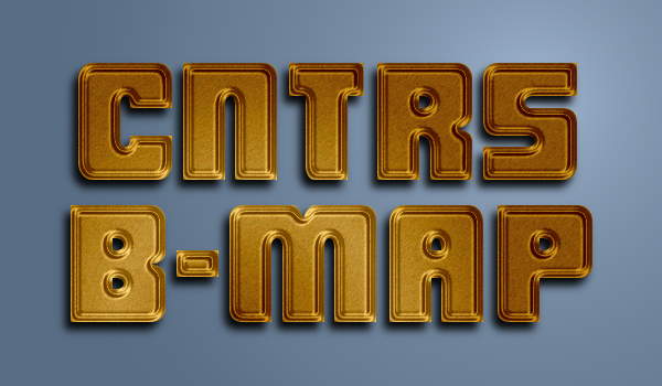

01. type your text as usual (grey is always a good color)
02. create a new transparent layer
03. alpha select your text
what we want is to create a bumpmap, but instead of blurring our text, we will do this "backwards", so
04. Select -> Feather and use a value you would normally blur
i used 12
05. fill with black and deselect
06. apply a Contour
07. create a white layer over your base-textlayer and under your feathered-textlayer
08. merge down feathered layer, so that you get your bumpmap: a white layer with black blurred contoured text
09. turn off BumpMap layer and activate textlayer - go to Filters -> Map -> BumpMap
10. make sure the Contoured BumpMap is chosen from the dropdown menu
11. decorate some more
and then some more :)
xcf.-file attached
ContouredBumpMapping.rar [486.09 KiB]
Downloaded 241 times

One thing I would point out, though it is somewhat trivial, if you make your text white to begin with then you won't have to worry about merging it with another layer to create a bumpmap.
The Bump Map filter treats transparency in the bumpmap layer as though it is black, so if you have created a black text layer, you end up with what the Bump Map filter sees as an entirely black bumpmap -- which is why you need to merge it with a white layer.
However, if you create a white text layer then the Bump Map filter will see the text as white and the transparency as black (which is basically what you want). If you use this approach, you should perform a "Layer->Layer to Image Size" before blurring to ensure the blurring won't get chopped off; and to be exactly the same as your black text on white background approach, you should check the "Invert bumpmap" option in the Bump Map dialog.
