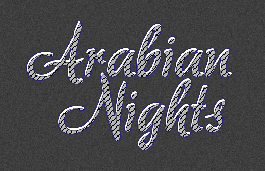

1. create your canvas, mine is 800x550 #3e3e3e
2. type your text, i used the font 'akaDora' 230px
(get it here: http://www.fontspace.com/akatype/akadora)
3. alpha select your text and save it to a channel for future use
4. we will start with an Outer Glow
create a new transparent layer, put it under the base text and fill the alpha selected text with blue #1000c0
deselect and Gaussian Blur by 5
reduce Opacity to 43%
5. next the Decor bit
this is an Inner Glow with a twist
create a new transparent layer on top of your base text
activate Channel to Selection
Shrink: 6
Invert
fill with yellow #f9e698
Deselect and Gaussian Blur by 5
activate Channel to Selection again
Shrink by 3 (!)
apply layermask from Selection
to get the arabesque-esque shape we will apply a Contour
use 'Sawtooth' but narrow the top of the pyramid shape from both sides a bit until you are satisfied
if you dont understand Contours, go to this thread and study it first:
http://gimpchat.com/viewtopic.php?f=10&t=6518
6. next a Highlight
create a new transparent layer on top of the Base Text
fill with white
activate the Move Tool and set it to 'Selection'
offset the selection, then hit delete
this is the same technique as you learned in my „Glossy Text“ tutorial
http://gimpchat.com/viewtopic.php?f=23&t=5808
Gaussian Blur by 5 and reduce Opacity to 60%
activate 'Channel to Selection', Invert and Delete to get rid of all thats outside the text boundaries
7. for some funky Highlights create a new transparent layer on top of the Highlight Layer
fill with the gradient 'Four Bars', set 'Repeat' to 'Triangular Wave' – the angle should be 45°
set Mode to 'Grain Merge' and reduce Opacity to 40%
8. duplicate Base Text Layer for a Dropshadow (its already black ;) )
Gaussian Blur by 5, set Mode to 'Burn' and Opacity to about 50%
Offset (Ctrl + Shift + O) by X:12, Y: 18
9. now some fine tuning:
change the colour of the Decor with your favorite method
i used 'Change Hue/Lighness/Saturation' with the following values, Colour-Curves is another option
10. add some RGB-Noise to the background Red/Green/Blue 0,04
11. apply a Contour to the Outer Glow
12. and you are done !
You can download the xcf-file, if you want to have a closer look at what i did.
's Arabian Nights.rar [827.56 KiB]
Downloaded 636 times

bbbbbbbbbbbImage
