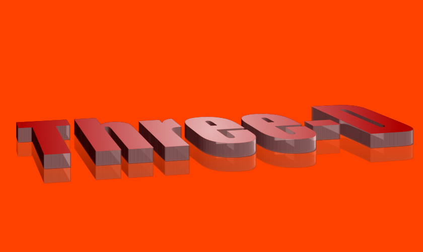

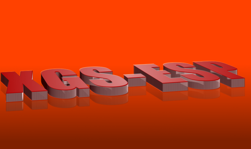

This is a very interesting technique. My first time thru the tutorial I used the same text as the tutorial, but accidentally left the Channel visibility on when I made the "New from Visible" layer. This made the background dark, but otherwise ok (of course the light band at the top of the text is due to this as well).
But when I changed the text, although the effect was still good, I didn't like it quite as much on narrow letters like the bottom of the "T" on the left.
Thanks to both Esper and Xgeous. :tyspin
looks good Jas45 !
what exactly do you dislike about the "T" ?
maybe there is a way to improve the effect
 Post subject: Re: 3D Text with a reflection - xgeous Style
PostPosted: Sun Mar 10, 2013 9:42 pm  (#7)
Joined: Mar 04, 2013
Posts: 105
Esper: I'm not quite sure. It sort of looks like it's stacked on top of a lighter box, rather than the reflection looking like a true reflection. That's not put very well, but I hope you understand what I mean.
I think if the reflection fades to "nothing" about 3/4 way down, it would look better to me. I may play with the layer mask later to see if I can accomplish this, and I would appreciate any ideas you have. The intersecting angles make it hard for me to think of a way to fade the reflection on both the bottom of the "T" and it's left side, as well as the other letters.
Don't get me wrong... I really like the effect. I was just trying to "fine tune" to my liking.

Esper: I forgot to mention, but my reason for posting two tries on this tutorial, is for comparison. The reflections on the top (the one with XGS-ESP) really look like reflections to me. I think the side of the letters came out darker, and the contrasting lighter reflections are believable.

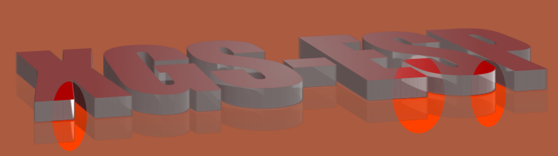

Esper wrote:
Jas45, i think i understand what you mean
as i had a similar dilemma some time ago when on tried to make a reflection for a different image
you said, it looks like two boxes stacked on top of each other
and i think the trick is, what are we actually looking at here ?
The problem is that the reflection isn't symmetrical:
You have to make the reflection quite dark/transparent to make these lighting effects invisible.

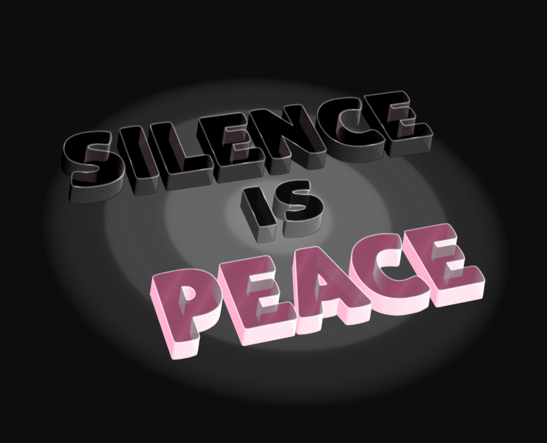

PostPosted: Wed Mar 13, 2013 9:43 pm  (#20)
Joined: Jul 17, 2012
Posts: 2769
