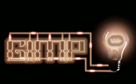

fencepost, see the result of your plugin "Animated path stroking" + Decorate path.

PostPosted: Wed Jan 29, 2014 11:13 am  (#5)
cool Carlos

Oh, Wow! That's snazzy, Carlos! Very nice and creative use of the script!

Thanks Molly and fencepost.

Wow Carlos! I love that. Really creative.
