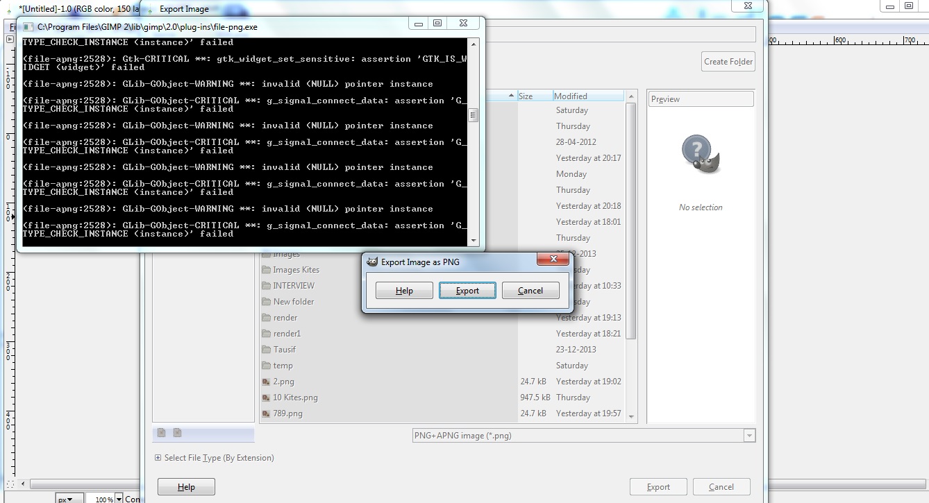

Hello there I'm currently experiencing some problems regarding APNG plugin usage in Gimp 2.8 under Windows 7 64bits, the problem is that I can't see the dialog, it is completely empty, only the export, help and cancel buttons show off, I've been digging around and the problem is within file-apng.ui, can someone help me out?
 Post subject: Re: How to set up your Gimp to accept apng format in Windows
PostPosted: Sun Jul 22, 2012 9:17 pm  (#109)
Joined: Jul 22, 2012
Posts: 3
Here is what I actually experience
PostPosted: Sun Jul 22, 2012 9:34 pm  (#110)
Posts: 16200
You need to make sure those two files ( the ui and exe ) are in the lib\gimp\2.0\plug-ins directory. They won't work in the user\.gimp-2.8\plug-ins folder. :)
Thanks!
