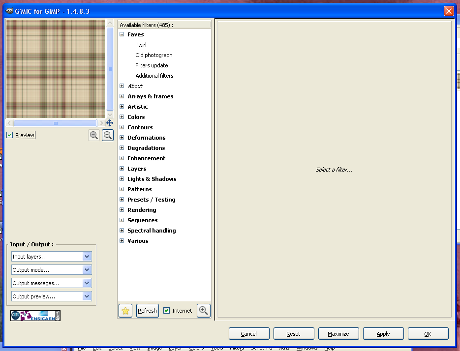

ok, this is what I made following the instructions.
quite interesting!!

Joined: Feb 06, 2011
Posts: 342
Ok back!! :rofl I drive myself nuts sooo..:)
Anyways, some how my applications data folder was totally hidden. :gaah Good thing my partner's was not. I found the .gmic_def.1843 file and I placed your folder you so kindly gave us into the applications data folder. I opened gimp and gmic and refreshed my filters to avail I got nada again. Something is just not right. :gaah
I will keep trying. I am a stickler for details why I struggled rewiring my tractor but it is done! :jumpclap Thanks for your help you so willing give Mahvin I do appreciate it. :) :tyspin
Liana
 Post subject: Re: Somewhat Painless Seamless Plaid Tutorial Using G'MIC
PostPosted: Fri May 13, 2011 10:32 pm  (#36)
Lianam: extract the file from the zip into the appdata folder location. It won't work still in a zip.
PostPosted: Fri May 13, 2011 10:41 pm  (#37)
Posts: 342
It was extracted. Heck I even downloaded it again to the application data folder and extracted it again it still does not show up in gmic. :gaah
Liana
PostPosted: Fri May 13, 2011 10:45 pm  (#38)
Hmmmmm... Did you try saving a filter as a fave in G'MIC? David said it automatically creates a .gmic file. And if it does, then you could just copy/paste the code into "that" file and see if it works.
PostPosted: Fri May 13, 2011 10:54 pm  (#39)
Joined: Mar 29, 2011
Posts: 346
Location: Wisconsin
mahvin wrote:
Do you have something personal against G'MIC or scripts and plug-ins? I'm confused, I can't tell if your hostile or you find discovery outside of GIMP to be insulting. I am clueless, please explain...
My apologies.
I was just trying to point out a simpler method. I probably should have posted it in a new thread.
Nothing against G'MIC, it's just that people always seem to have trouble with it. But that's part of the learning curve.
Peace...
PostPosted: Fri May 13, 2011 11:02 pm  (#40)
Posts: 342
Well I have not knowingly placed a filter in the favs but I do have filters in that file I have no idea how they got there. :rofl I will post a screen shot of my GMIC and see if it sheds some light.
Liana
