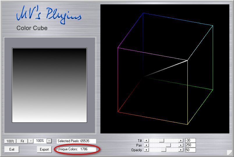

Is Color Cube Analysis an accurate count of Pseudogrey?

PostPosted: Wed Jul 18, 2012 5:28 pm  (#36)
Another look at 1786 True Pseudogrey gradient.
 Post subject: Re: True Pseudogrey in GIMP.
PostPosted: Wed Jul 18, 2012 5:43 pm  (#37)
Posts: 12870
Yet another cool way to count colors. Assuming the gradient that you created was straight black to white. Cool that if done right, it gives you the 1786 tones per the Pseudogrey specs. Might try the color cube analysis the next time I do a Pseudogrey odinbc. :)

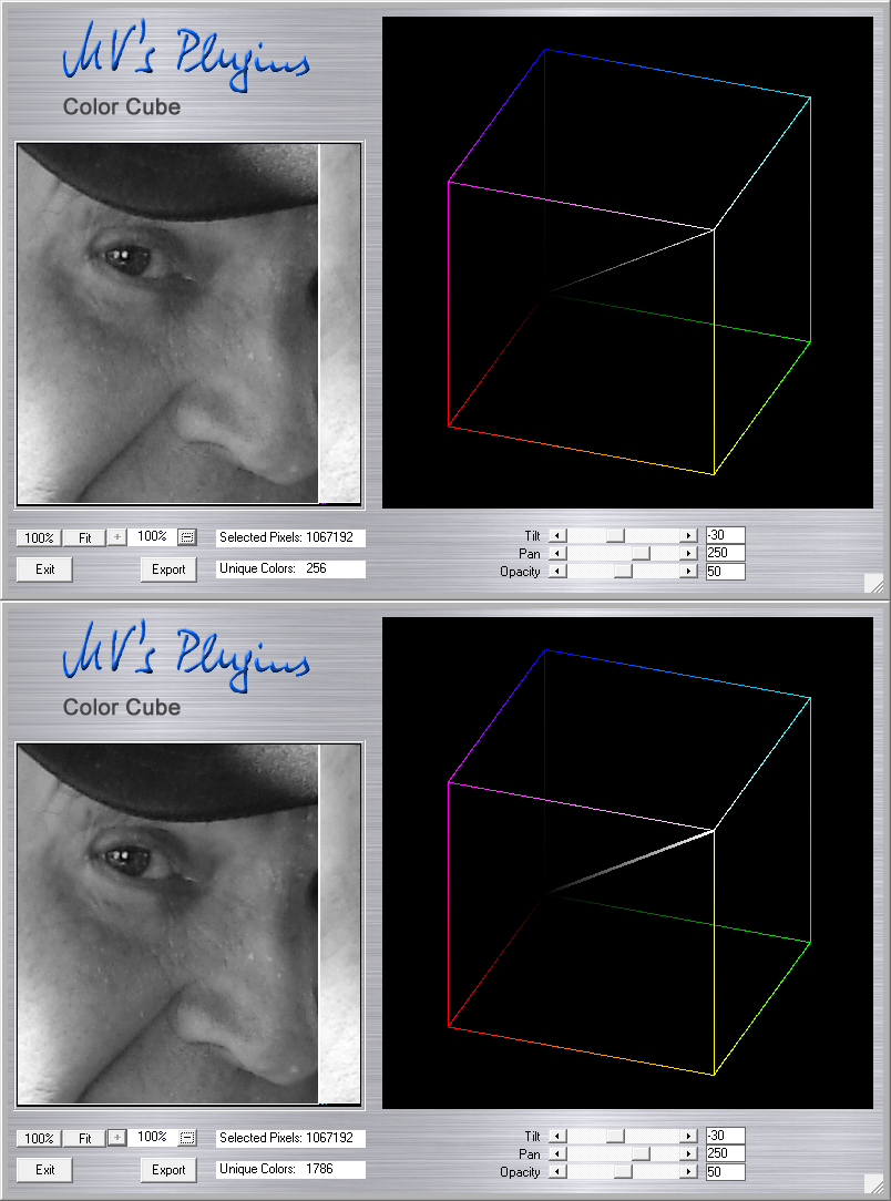

Where can I get this plugin odin; thought I had this one, but color cube in GIMP (thought the name was different; lol) is not the same. :)
PostPosted: Wed Jul 18, 2012 6:49 pm  (#39)
MV's Plugins the Wire Worm guy.
http://www.vicanek.de/
I used your gradient from here,
viewtopic.php?f=10&t=4245#p52399

Thank odinbc; the plugin works great in GIMP too which is cool (haven't tried wireworm yet but remember the thread where many here touted its coolness. lol). Did a comparison and you can see that the color band is wider then then straight desat version. :)
