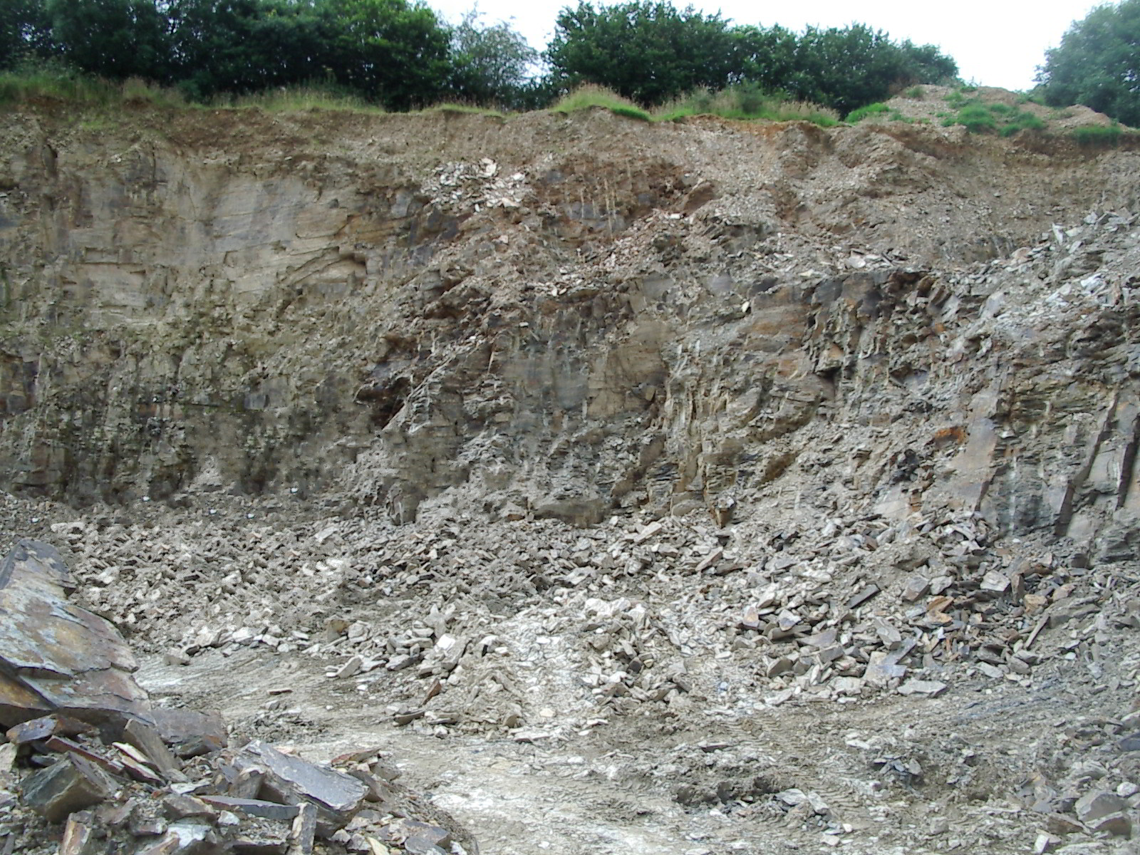

Just a side note, if you wanted to avoid any nasty sharpening artifacts and get a cleaner texture, there's a couple of other things you could try as well.
One is to "slice" up your healing selection into sections that are more amenable to resynthesizing. For instance, you could have chosen just the bucket portion of the earth mover, and then set Heal Selection to sample from the sides only (because the primary 'seam' of the rock textures occurs on either side). Continue doing this with sections to get the best results you can.
Another thing is that you could use Resynthesizer directly, instead of a helper script.
For instance, you could select another area of your image that has textures that would be good for replacement in your output, and copy/paste them to a new layer. Choose that layer as the input on the Resynthesizer dialog, and have it create a new texture for an appropriate place in your final image output. (this was a quickie test to show as an example):
File comment: No sharpening, just creative use of selections and straight resynth.

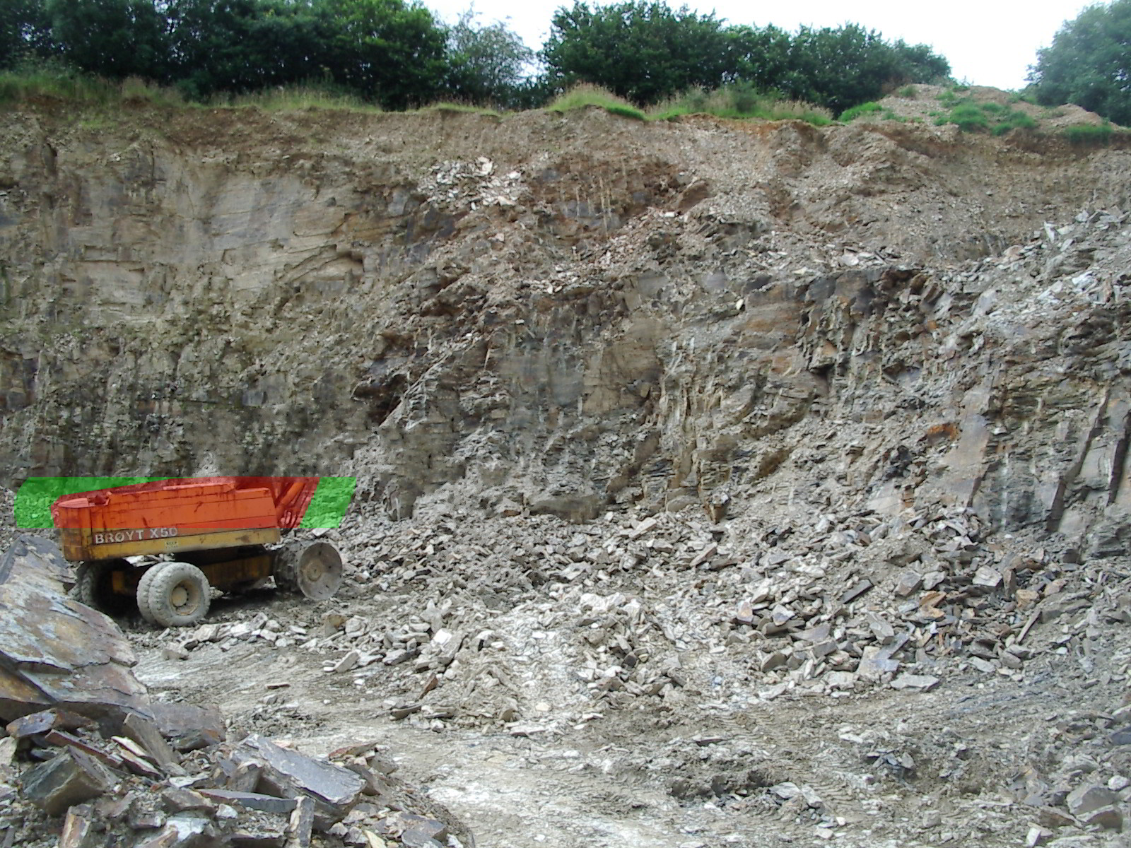

Ok, hopefully I can make myself clear here...
When considering the base image, I try to look for areas of the object that I want to remove where the surrounding textures are candidates for good replacements.
For example, to remove the bucket of the machine, I can clearly see that textures on either side of the bucket are the best candidates to replace it... (Red is what I want to remove, Green is where the "Heal Selection" option will pull textures from - in this case I told it to use the sides).
File comment: Removing the bucket (Choose to sample from the Sides for best results)

For the top half of the machinery, I can again use Sides to gather the textures:
And I would pretty much be done using any helper scripts at this point (Like Heal Selection).
The reason is that the foreground rocks on the left of the frame will make it hard to get a clean texture to finish removing the machine body...
So what I did at this point was to switch gears to a different method.
To the right of the machine in the rock field (roughly on the same plane as the machine lower body), I just selected a section of the ground and rocks, copied it, and pasted it into a new layer called "Base".
Then I selected what was left of the machine body on the image layer, and ran Resynthesize directly.
When the dialog comes up, there is an option to choose the Input Texture source. I chose the pasted layer "Base" as the input source, and checked all the options for output. Then I just hit OK.
Resynthesizer then rebuilds a texture to fill in my selection based on the texture source, which happens to be a clean bunch of rocks and texture from a different place in the image.
And finally, here's the result (with no other touchups at all):
