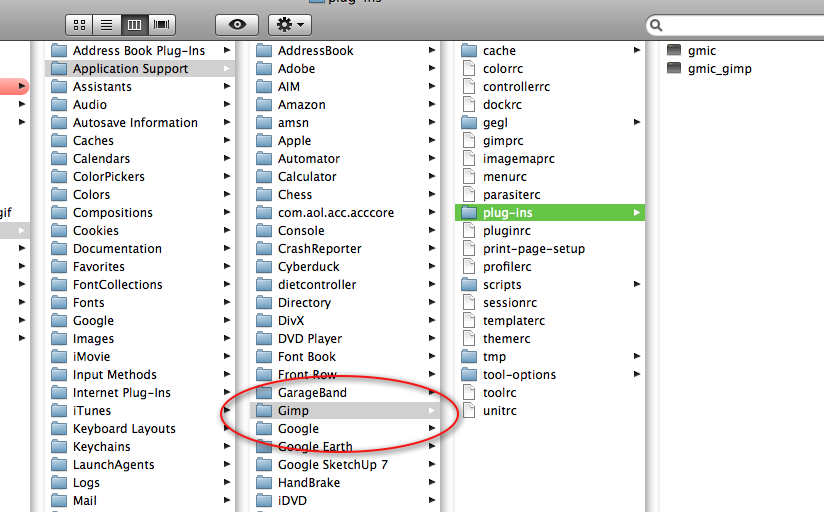

Does this help any?

 Post subject: Re: Adding G'MIC to Mac OS X 10.6.7
PostPosted: Tue May 31, 2011 11:19 am  (#42)
i get the impression there is something quite wrong in your users folder but luckily should be easy to fix :
Just DELETE the whole Gimp user folders: if gimp was installed correctly it will RECREATE the folder at next start
(if doesn't then is better unistall everything, but i believe not the case )
about your last screenshoot, not sure that gimp in Mac create a entry in application support , i doubt because in windows or linux does nothing equivalent

Do you mean delete the folder I have circled below?
PostPosted: Tue May 31, 2011 2:36 pm  (#45)
yes
PostPosted: Tue May 31, 2011 2:37 pm  (#46)
Is this the one under Users/homefolder/library/applicationsupport/Gimp? If so, then yes, delete this folder. If GIMP is installed correctly, when you reboot GIMP, it will recreate all the folders automatically.

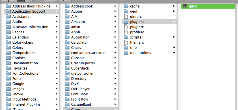

ok, done that... and this is it now (I have added back in the script folder and the plug-in folder, plus the two scripts I have and gmic (which is still not showing in Gimp, and there's no solution on the horizon).
Is it of concern that there are no brushes, patterns, gradients in there?
