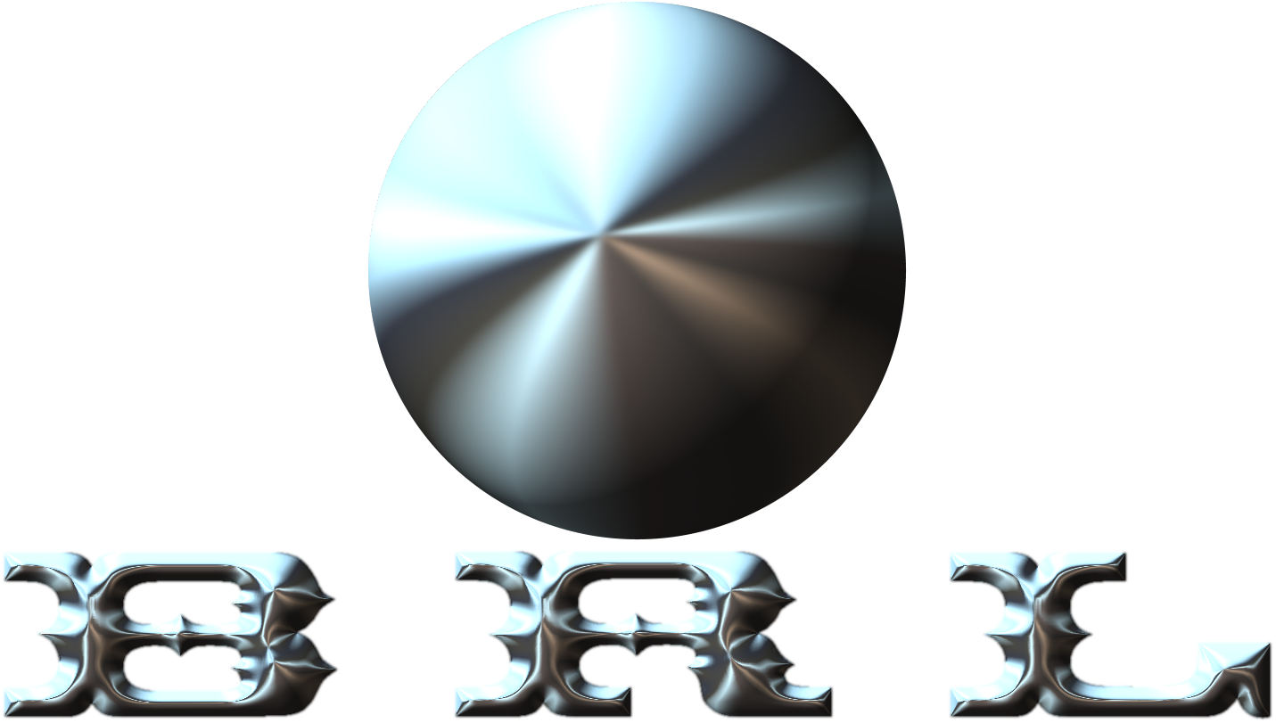

Very nice tutorial. I'll try it and hopefully I can make a chrome beveled effect.
Thanks Adventure. Maybe this will help.

Gblur the sphere before you save for a shiny finish. SEE #13.

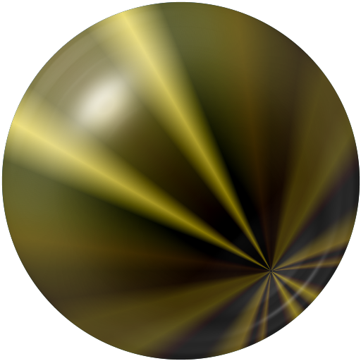

Been creating a few but this one I am pleased with, took the gradient from this wallpaper I had created but applied a different technique for the sphere.
And the results
Attached is the Map and Gradient
Grad-Brl-07.ggr [2.54 KiB]
Downloaded 331 times
