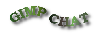

File comment: From Mahvin's tut
File comment: From O's tut

Oh, Liana, those are superb. Excellent work. Keep on gimping. You're gonna go far. :gimp

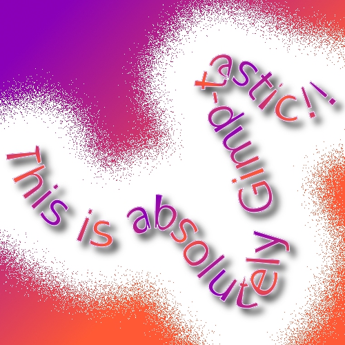

Excellence made simple! Very well done!
My Sigs = My Photos

Greg's been playing in the spray paint again. That is great, Greg!
