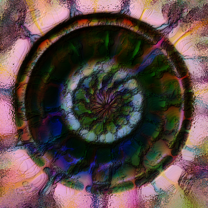

PostPosted: Tue Jun 27, 2017 7:08 pm  (#9)
Just love the color combinations that you get with this tutorial!
