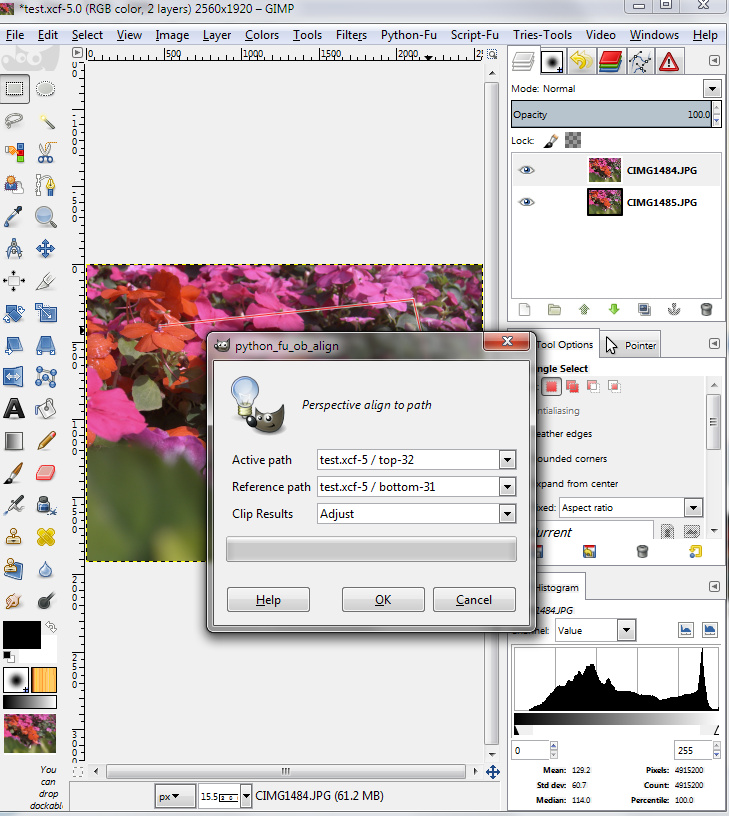

There are times the image registration doesn't do what you want, the perspective transformation doesn't allow you to see through the target image. I decided to write my own script to help. I know I should have bring the tripod, get a wind shield, but I am only an ordinary photographer with a fixed lens, weighted 269g, camera. How this work?
1. create a 4 points path for the target image

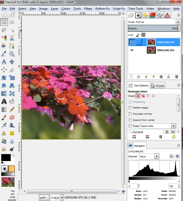

2. create a 4 points path for the active image which match the same reference points in the target image
3. run the script under filters/distorts/Align to path
This is an ad hoc version and not much error checks, let me know if you have problems.

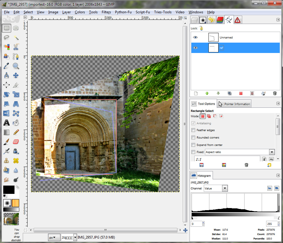

You can also do things like setting 2 paths, one for the object and one for the desired shape and apply the script. Example on Issa's monasteries.

okyl168,
Please excuse my butting in on this thread, but could you explain what you have done on Issabellas monastery picture (above).
I tried to achieve the same result by a different method and failed miserably!
david.

david wrote:
okyl168,
david.
1. create the target path (click on 4 corners of the rectangle), see the red lines in the image and name it ref
2. create the active path (click on 4 corners of the monasteries), see the blue lines in the image
3. run the align to path script, select the active path on top, select the ref path for next, then click ok
4. The changes will apply on the selected layer, you can run fit canvas to layer to show the new image.

So to transform Issabella's monastery pic:
- select Path Tool, then click on each corner of the portico in turn (say bottom-left, top-left, top-right, bottom-right);
- in Paths dialog, rename path as "active";
- in Paths dialog, right-click and select New Path ..name it "ref";
- click on each corner of the rectangle (or other shape) that you want to transform the portico to, in the same sequence as used for the "active" path;
- run Filters>Distorts>Align to path, select the "active" and "ref" paths respectively, then hit OK.
Just before running the plugin:
After running the plugin and then Fit-canvas-to-layers:

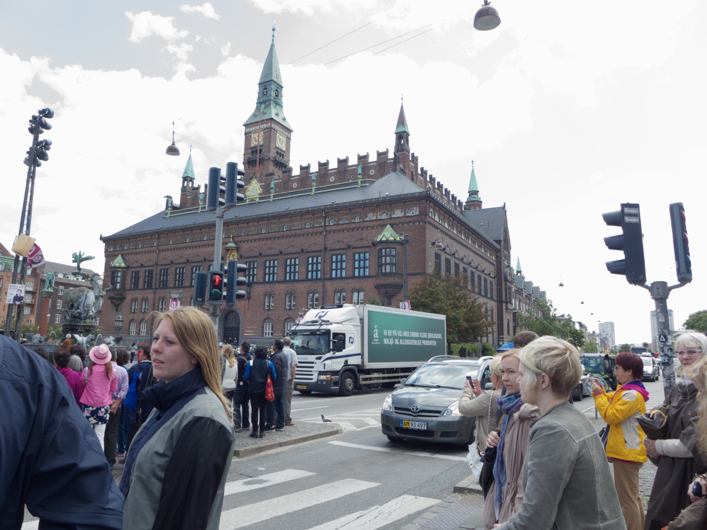

Got an example I can show what it does, here I got 2 images taken at few seconds apart without tripod at a busy cross junction.

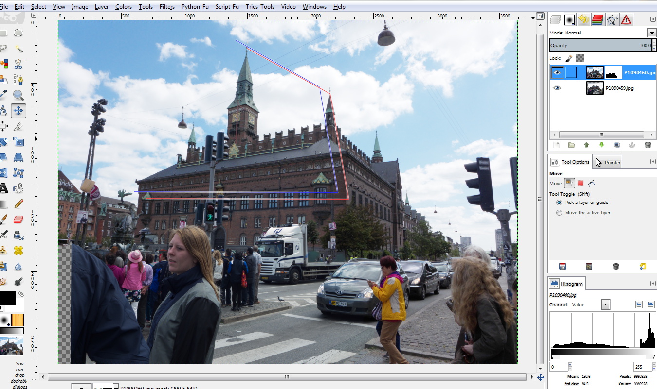

after applied align to path where the fixing is the building
The result in difference mode, as you can see only the building is aligned.
