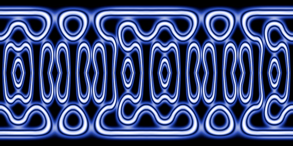

i wanted a nice border pattern to turn into a frame for a card i was making, and i came up with this fun and easy way of making it based on some g'mic filters. to remember how i made it i made an xcf of one of these patterns, where each layer represents an action, described in the layer attributes and a result, shown on the actual layer. here is the resulting border pattern of that particular xcf, but variations are endless. i'll write down the steps here, but if you prefer to look at the detailed xcf i can post that too.

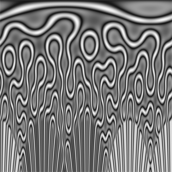

Thanks Anmal. I didn't do the last two steps as I liked the Art Deco style on the bottom, so I saved the tile as is.
:tyspin

kimba: this is funny - you liked the art deco look of the stripey part of the pattern, and i liked the first one i made so much because of the art nouveau look of the swirly part of the pattern :).

Nice result AnMal, I'm sure I'll use it anywhere and it will give it a touch yours. :) :tyspin :paint
