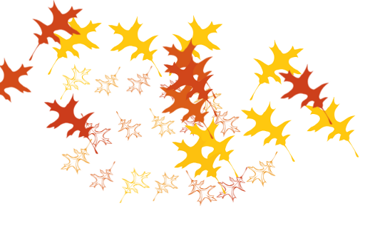

Here are my brushes I made animated. I had them in my file I just made some changes to what I wanted. :paint
I liked the ones canadian leaf and music notes notes in a previous tut from O and Molly. thanks for the brushes. :tyspin
Liana
I added my brushes hope it works :)
oak leaf.zip [89.95 KiB]
Downloaded 489 times
File comment: oak leaf..one colored on the edges the other solid.

Those are very nice, Liana. Thank you for sharing your brushes with us.
