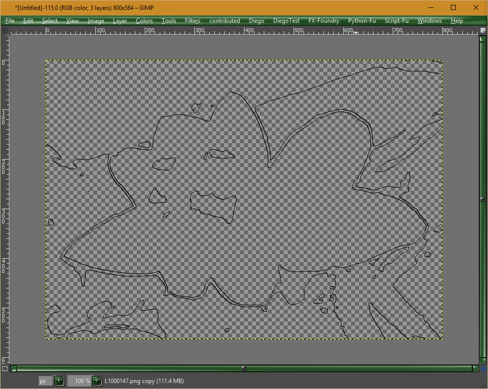

Step two: Run Isophotes:

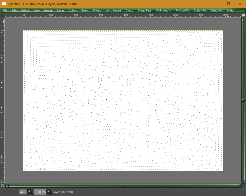

Now stroke the resulting path with a dot.

Result of the stroke:
Threshold the dots (turns out you can do this; I didn't play with this when I tried when I first started rendering these as I should; tried to convert to 2-bit but that didn't work. Saving as PBM and then using the result does work, but apparently Threshold works too so this is the better way of doing this):

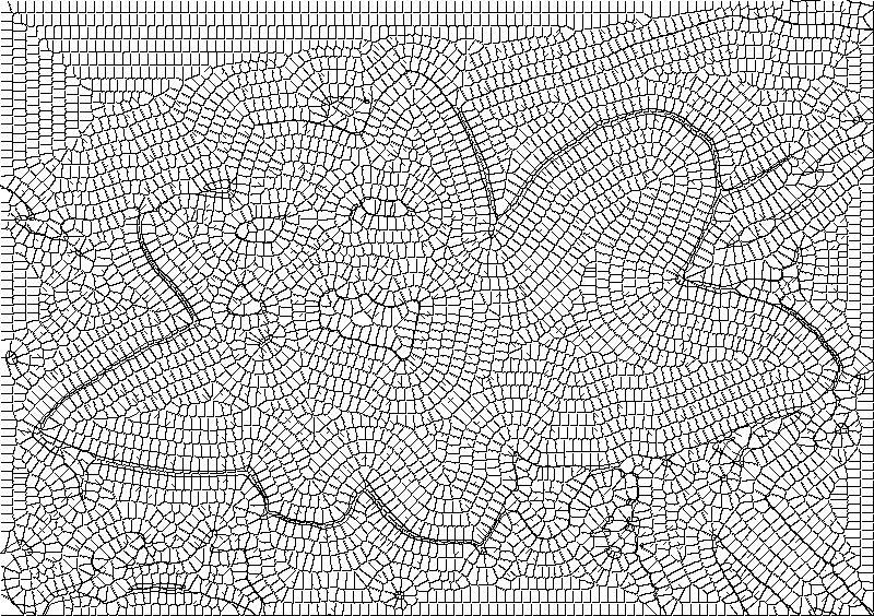

Once you do this, run Skeleton (quick):

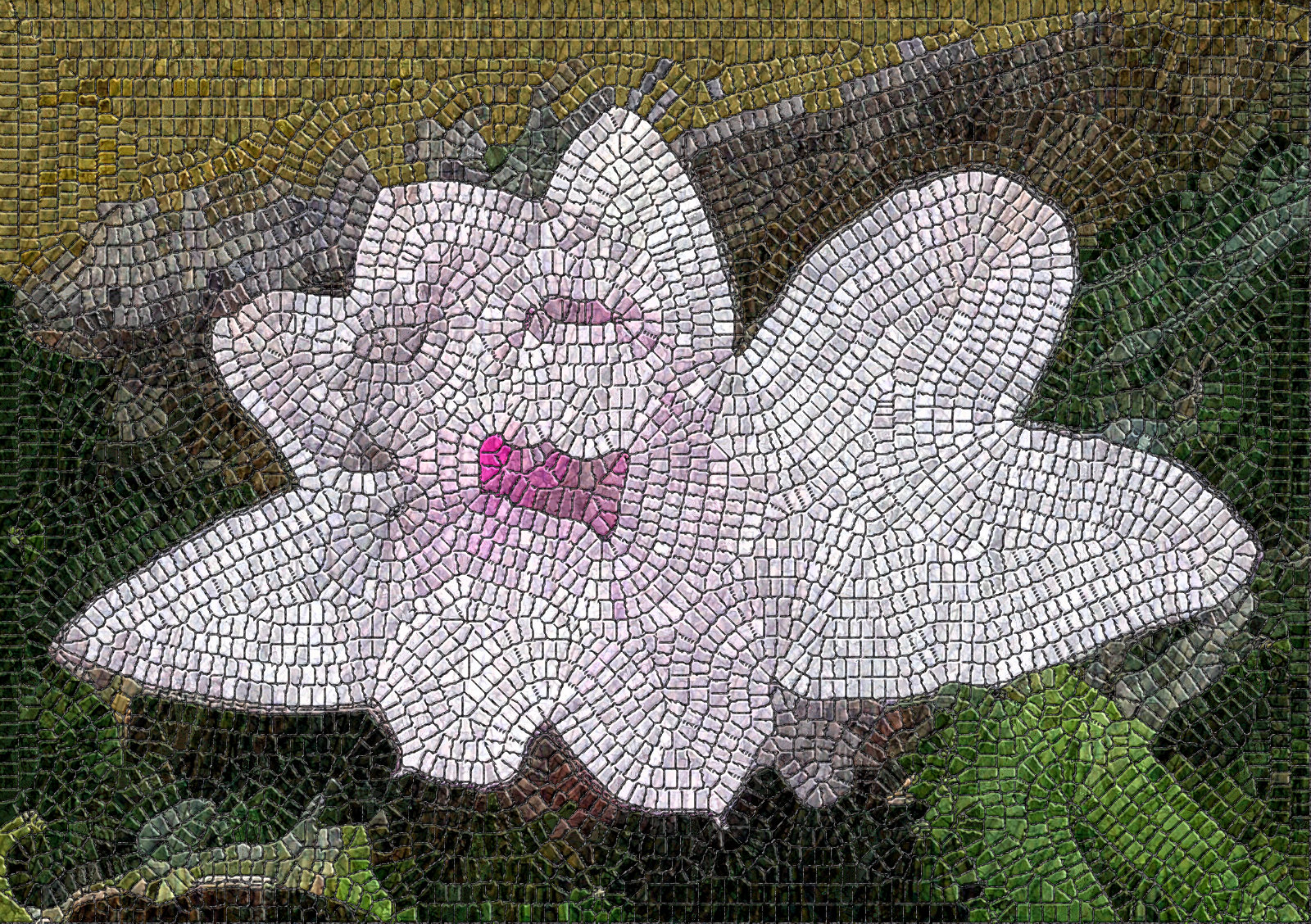

OK; the result (resized and embellished; not going to do a tut on that). :)

My problem is arriving to the phase where all lines(paths) are converted to dots, i.e. arriving to have a layer which does only show "designing" dots. I'm terribly incompetent with paths.

maybe (but only maybe) these could be the substeps after having run Isophotes:
- select a transp pixel on the outcome (to get the shapes otherwise RobA script takes the contours of the image to start drawing paths)
- run RobA script with defaults (paths are created according to the shapes)
- invert selection (to have the Isophotes drawing lines selected)
- cut (to remove the isophotes drawing lines)
- select all
- stroke the path with solid colour 1 px and line type "sparse dots"
- fill with White everything except the dots (either of these two ways: add a White layer below and merge down the dots layer, or select again the transparent pixels and fill with White)
- delete the path
- threshold the dots
- run Skeleton
- (at least in my case) run Repair Inpaint Holes (I had a pixel inside each Tile)
I got something which looks like a base to continue

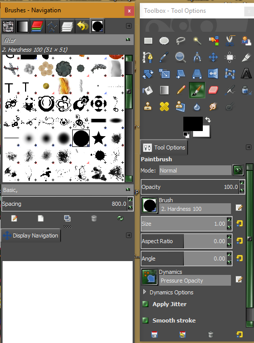

Need to stroke the resulting path with a 1 pixel brush with 800 to 1500px spacing Pat. The path is created by Rob's Mosaic helper. You then need to Threshold the pixels per the tutorial. :)

Once you stroke your paths, you then need to use threshold to make the dots all black (since they won't me). After that, run Skeleton preset, Pat. :)
