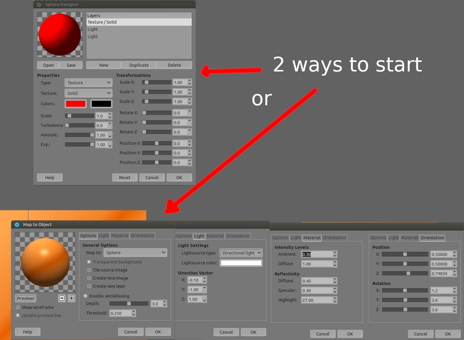

I'll try to explain, using only 2 filters in GIMP to make an egg with its typical oval.
1) create a squared transparent image
2) depending what you want there are many ways to start, I'll speak about just 2 ways as they are extremely simple:
first way
- Filters / Render / Sphere designer...
- then Rotate transform tool, put the shadow at the bottom.
or
second way
- Put a color or a gradient or whatever picture, pattern and so on the layer.
- then Filters / Map / Map object...
3) then for which either way you did start above, just do
Filters / Distorts / Curve Bend...
Done ;)

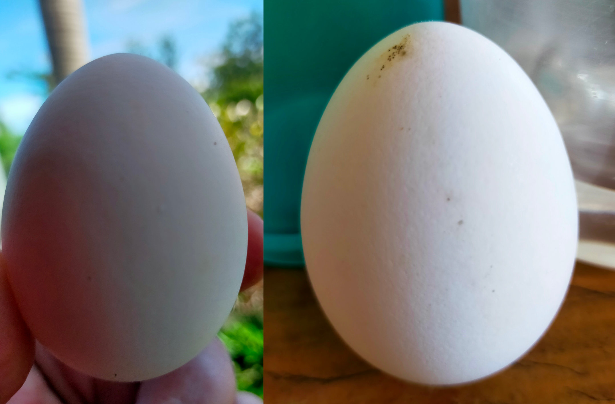

I did a photo of a real egg to compare shapes (see below).
Pocholo wrote:
1. The first thing I want to tell you about the egg shape; not all eggs are created equal. As you see my egg Shape look more like the real egg shown in the other photo.
I do need to say that the egg you are comparing is the wrong "real" egg...
This is an egg you've found on internet where that egg was heavily retouched by photographer Serghei Platonov, resized to fit Instagram format by Chris Godfrey => thus you don't know if it was slightly flattened on top or whatsoever during all these processes between different people...
So to do a comparison with a true REAL egg, I just went to my fridge and look at an egg... (and made a picture with my phone)
Egg taken from my fridge (bought at the wet market)
Now I can say that my egg shape look more like the real egg, and it was made with the wonderful the Samj's filter.
Having said that, Serghei Platonov did say it was a bird's egg, without specifying what kind of bird, and I fully agree that eggs from different birds' species will have different shapes, you are right.
Where I cannot agree, is you made a comparison with an overly post processed photo, resized by some else than the original photographer and tell "As you see my egg Shape look more like the real egg", IMVHO if you don't know how it was processed, it cannot be a "real" egg ;)

@Pixlab - I have never in my life seen an egg this shape. Maybe some exotic creatures lay them like this but I have never known an Easter egg like it.
Pocholo's is a far more realistic shape.
 Post subject: Re: How to create and simple Easter egg using GIMP and G'MIC
PostPosted: Sat Mar 19, 2022 10:33 am  (#13)
Thank you Erisian! Yes me either, I guest it was the last egg the bird pooped and it was deformed :hehe :rofl
