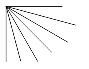

My experience has been that holding down Shift, then the Ctrl key constrains the line to 15 degree multiples.
File comment: Angle Constrained (Ctrl key) Lines
Ah! Another good thing to know. Thanks!
 Post subject: Re: [TIP] Straight pencil lines
PostPosted: Fri Jun 03, 2011 3:26 pm  (#6)
Indeed.
