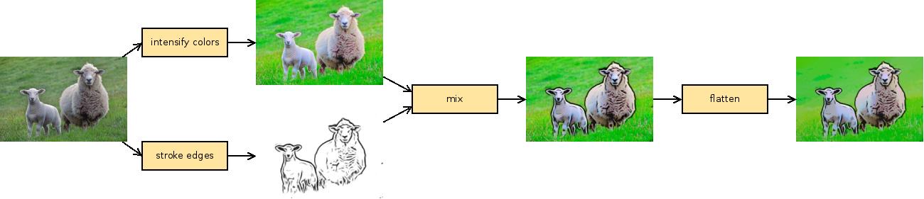

1) The big steps
Here are the four big steps:
  • Intensify colors, that is:
    • On bottom layer, "Colors -> Saturation (scale=1.8)"
    • On bottom layer, "Colors -> Hue-Chroma (lightness=10)"
  • Stroke edges (the big part), that is:
    • On top layer, "Filters -> G'MIC-Qt -> Repair -> Smooth [NL-Means]"
    • On top layer, "Filters -> G'MIC-Qt -> Repair -> Smooth [Bilateral]"
    • On top layer, "Filters -> Edge-Detect -> Difference of Gaussians (legacy)" (uncheck "Invert" option)
    • On top layer, "Colors -> Desaturate -> Desaturate (mode=Value)"
    • On top layer, "Colors -> Invert"
    • On top layer, "Colors -> Threshold : about 210-240, 255"
  • Mix, that is:
    • On top layer, set "layer mode" to "multiply"
    • On top layer, "Merge down"
  • Flatten, that is just: "Filters -> G'MIC-Qt -> Repair -> Smooth [Bilateral]", multiple times
The very difficult step is "stroke edges".
To be continued...

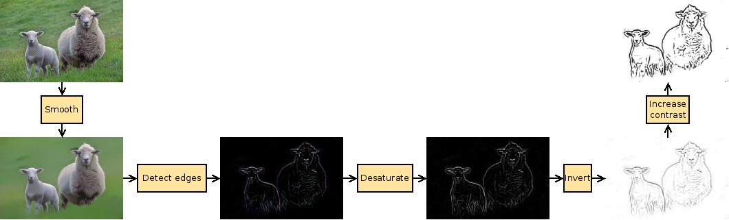

2) The steps to "Stroke edges"
Here are the five steps to "Stroke edges":
  1. Smooth, that is:
  2. Detect edges, that is just: On top layer, "Filters -> Edge-Detect -> Difference of Gaussians (legacy)" (uncheck "Invert" option)
  3. Desaturate, that is just: On top layer, "Colors -> Desaturate -> Desaturate (mode=Value)"
  4. Invert, that is just: On top layer, "Colors -> Invert"
  5. Increase contrast, that is just: On top layer, "Colors -> Threshold : about 210-240, 255"
There are three choices to do:
  • Which smooth (I haven't understood the reason why one smooth works better than another one)
  • Which edge detection (see following posts)
  • In which order, to do the steps 2,3,4 (see following posts). There are three possibilities:
    • Detect, desaturate, invert
    • Detect, invert, desaturate
    • Desaturate, detect, invert
To be continued...
