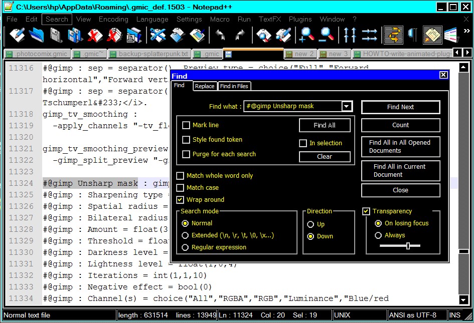

Now find something there may seems hopeless but look the Notepad+ menu and click Search/Find
The name of all the filters of the gmic plugin start with "#@gimp" ...so if you want to resurrect "Unsharp mask" you should search for "#@gimp Unsharp mask" ...click Find and
done...now the never-ending file was automatically scrolled to show you the right code :jumpclap

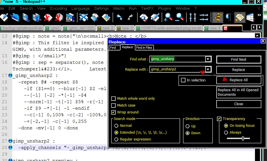

Luckily we may use again the magic of Search/Find this time we use the "replace" tab, write "gimp_unsharp" and as replacement "gimp_unsharp2" then click "Replace all"
