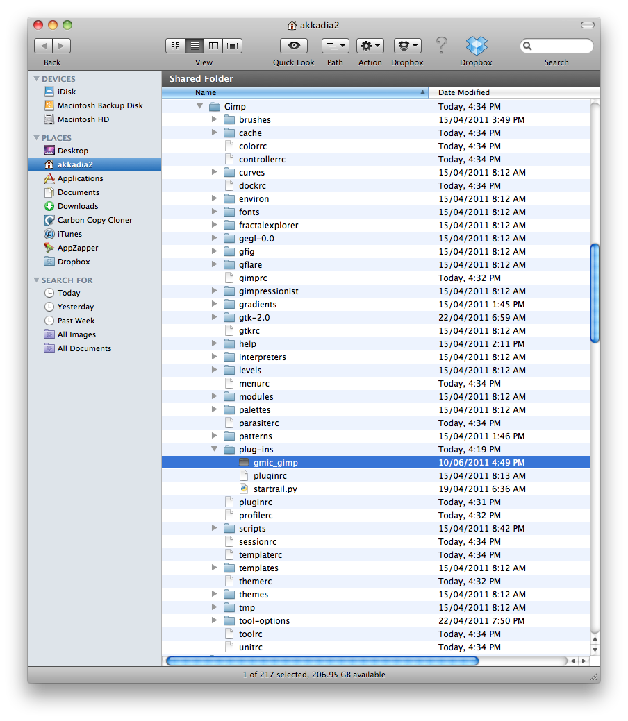

download GIMP 2.6.11
Download gmic_gimp 1.5.0.0 beta for SnowLeopard
Place the gmic_gimp file in the plug-ins folder by navigating to
/Users/yourhomefolder/Library/Application Support/Gimp/plug-ins and dropping it in the folder.
Right click on the gmic_gimp file and then get info.
This will open up another box which will display a url like address for the plug-ins folder…imperative that you use this and do not try to type it in by hand.
So hilight this and then right click to copy.
Assuming you already have GIMP open, navigate to Edit/preferences/Folders/Plug-Ins.
Click on the white paper icon and then right click paste the previously copied address in the address bar…then click ok….
It is important that you use the mouse to R click copy and paste as it may not work if you use the keyboard commands…If you are using a mighty mouse and do not know how to do this then message me and I will help you to configure your mouse to be able to right click.
restart GIMP
This does work as I have tried it and have it running.

I downloaded the new 1.5 version of gmic_gimp for my OS and placed it in the plug-ins folder . I got a prompt saying do you want to replace the existing one my answer was yes...I didnt really have to do anything else...as it automatically trashes it then. but for anyone who hasnt got it in the first place then you need to follow the instructions I have given for installing, depending on which OS you have...
