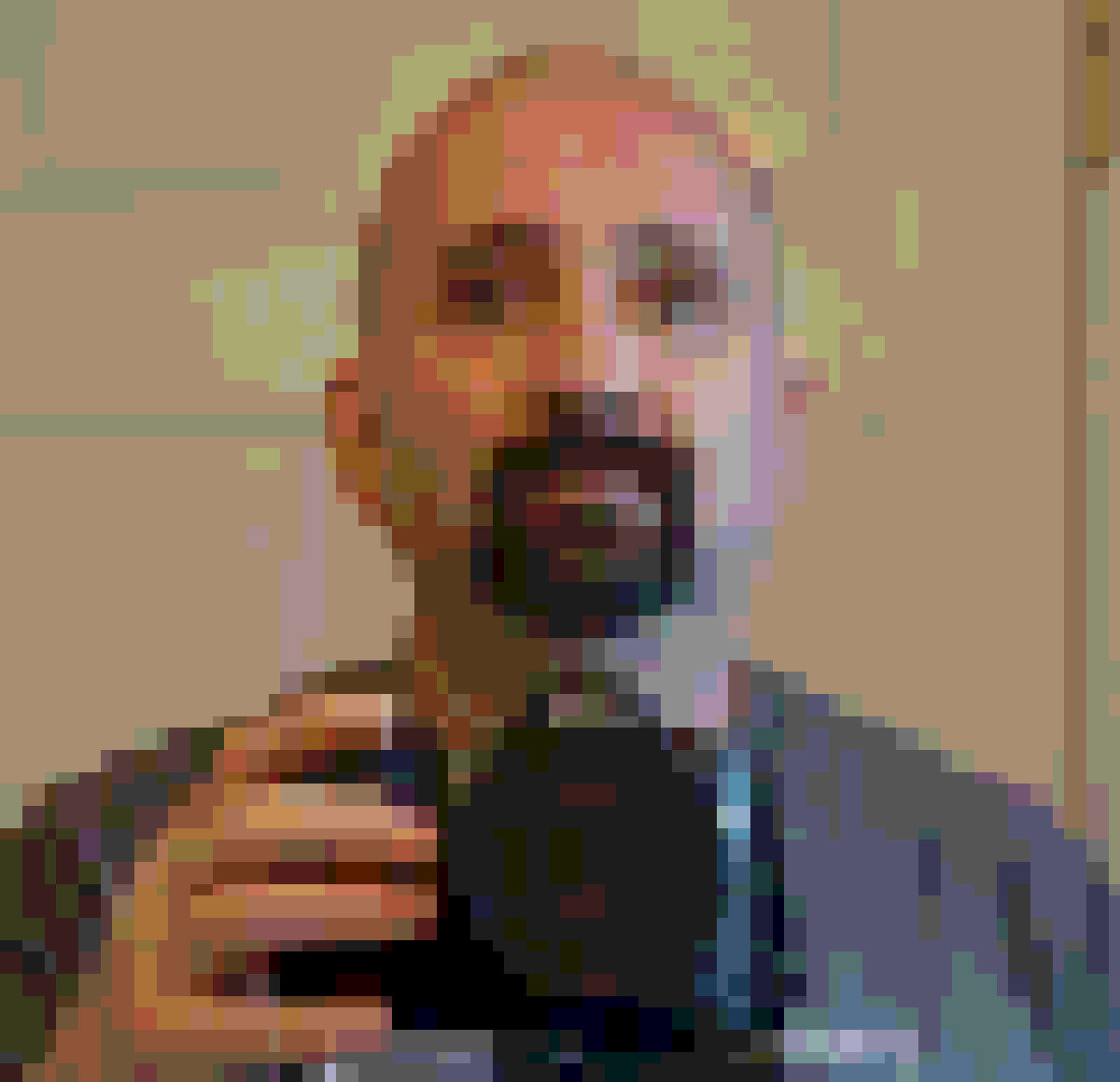

Now you run Blur>Pixelize (Here, there's rool for play, but I choose a radius of 20). Follow this with Poster set to 10.
Now run it through Filter Factory>Vasarely Mosaics set to 12 (play here too; value chosen depends on Pixelize radius; you can also choose 30 to go the other way).
Now run G'MIC>Contours>Isophotes (default settings) and then choose the select regions tool and just click on a transparent part that is a results of Isophotes (may want to Ctrl-T to hide the ants since the ants significanly slows down the next step). Also, reduce selection size (play with this too, I chose 2). Delete the Isophotes Layer (no longer needed).
Now that you have your selection islands, run Saul's cool Script-fu then copy and Paste as new (desregarding your original of course; I know; sloppy editing. lol).
To add dimension, just dup, run motion Blur (5 and angle of 235) on the base layer and dup that layer a few times til solid and then Merge just those layers. Then create a new Mid layer with either texture or just Black set to Overlay and then blend opacity to taste. This step gives you bricks. Fill the base layer with white and you are done (much simplified; texturizing is also the other option of course). :)

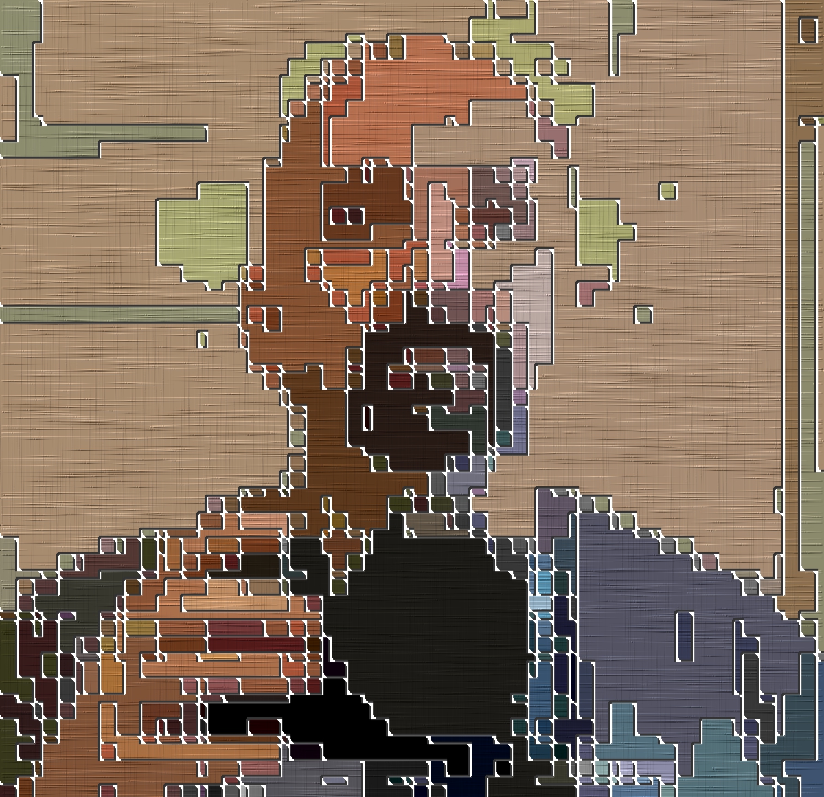

Here's my first try. I added some texture and drop shadow. Otherwise it's pretty much the same.
My Sigs = My Photos
 Post subject: Re: Neoplasticist inspired technique.
PostPosted: Fri Dec 10, 2010 6:50 pm  (#9)
Posts: 12851
Drop shadow works too PM. Like your abstract minimalist interpretation too Kevin. :)

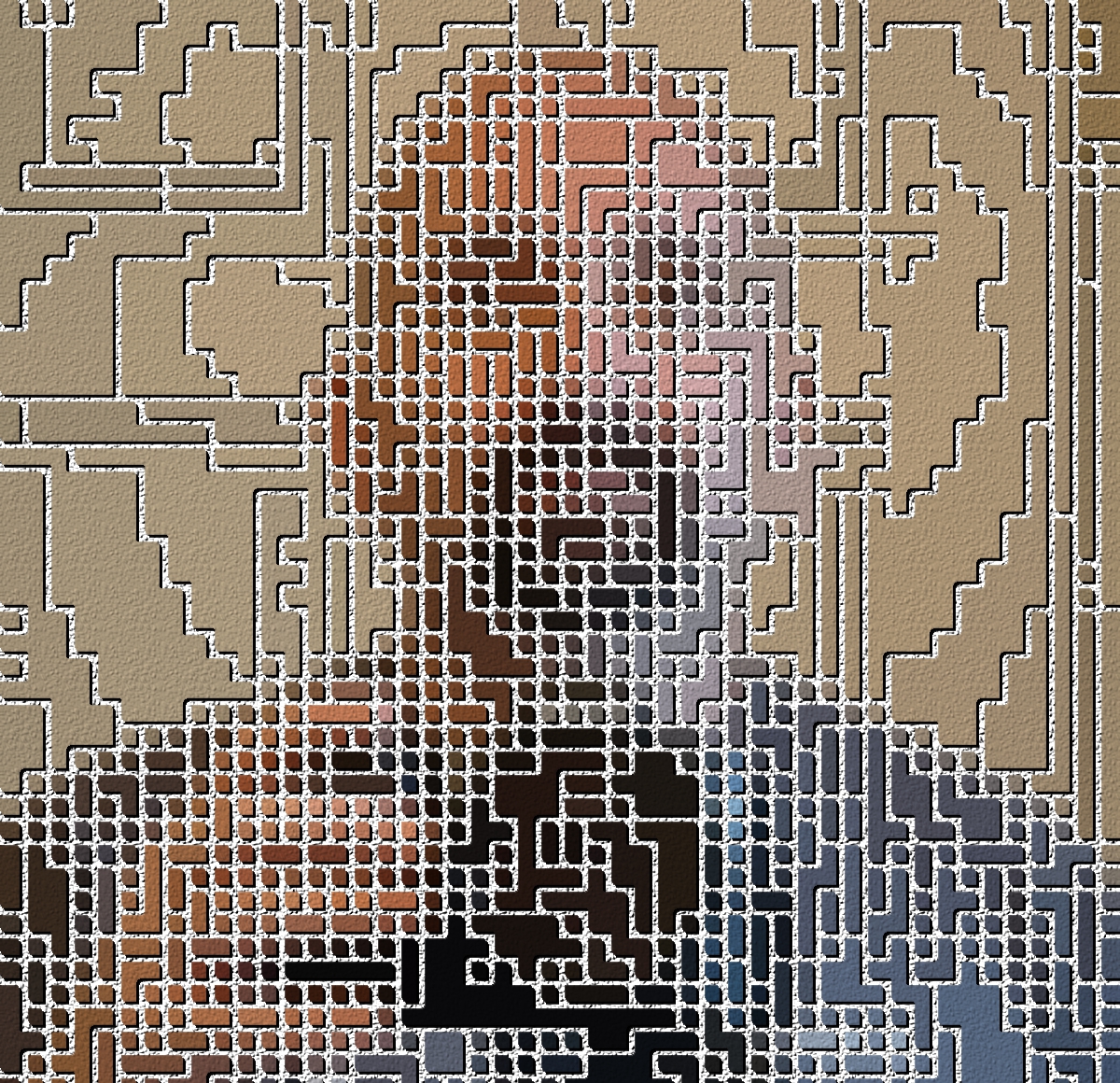

Attempt #2 - Some modifications.
My Sigs = My Photos
