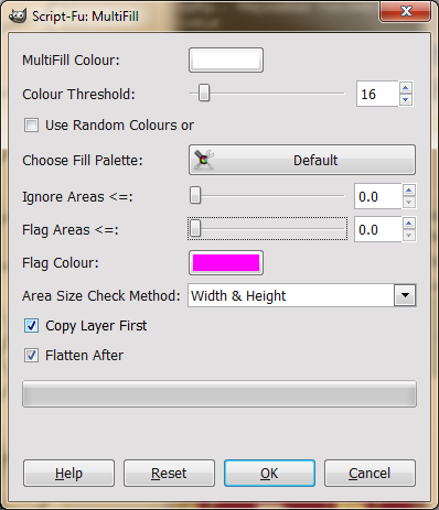

Posts: 12850
What version of Multifill are you using Drac? My version doesn't have the features yours does and when I went to the registry, mine is the same as that at the registry. Screenshot of mine below. :)

Lyle,
I looked up the link at the Registry to put it in my tutorial but the one I actually downloaded was the one Rob A posted in another thread. It's this one..
viewtopic.php?f=11&t=3776

Posts: 12850
Thanks Drac; that version is 1.7 and the one at the Registry (and the one that I indeed had) is 1.3. :)

Sorry about that...I had no idea that it has not been updated on the registry. As soon as I read your post I changed the link in the tut so no one else would get messed up.
