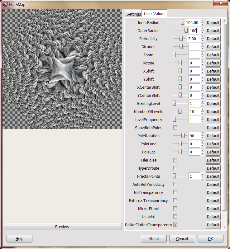

First fill a large and square texture (add alpha transparency; you'll see why later) with your fill and then run Mathmap>map>Droste preset as shown:

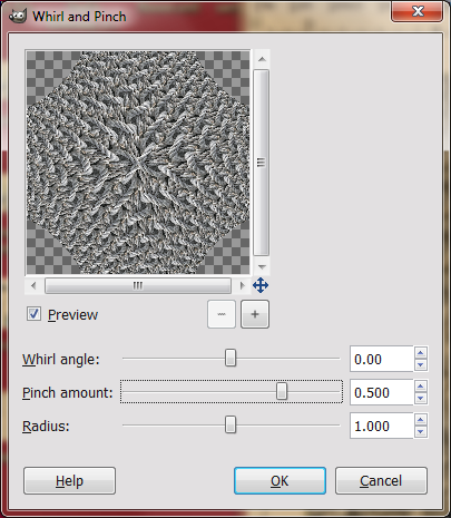

Then run Whirl and Pinch filter as shown:

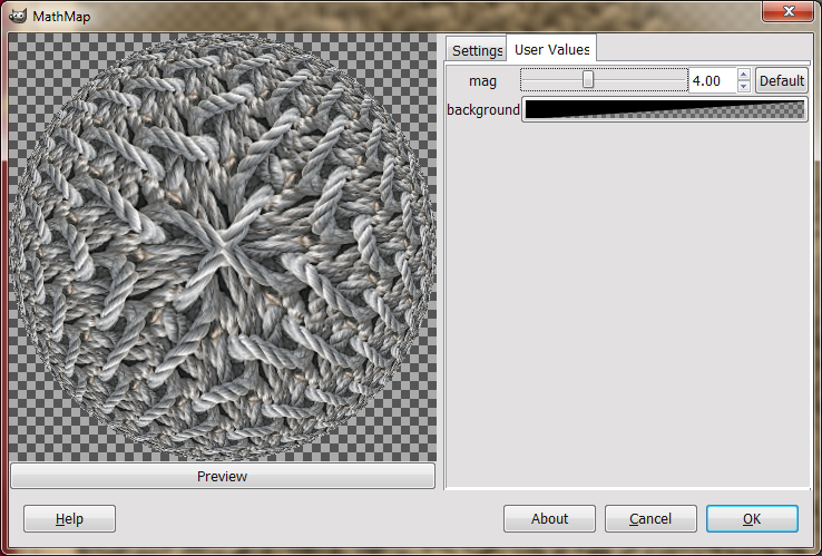

Now run the Mathmap>Distort>Sphere as shown (move slider for background transparancy. If you don't, your blackground will be black and you might want to use another background):
Now I just flattened (my background color is black) so it is what it is. :)
