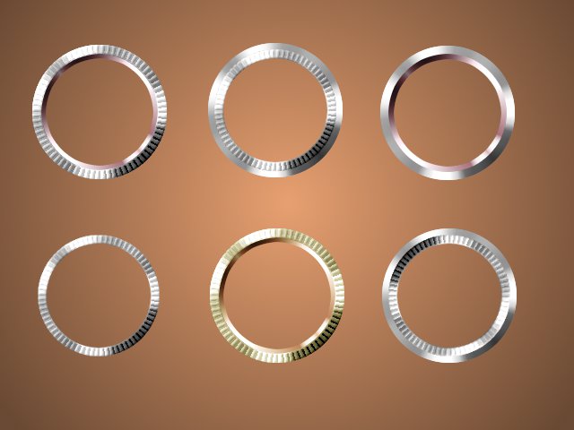

To save each combination, turn off all layers except the selected bezel type and it’s associated color layer above it. Save as file type ".png" making sure you uncheck the box in the save dialog where it says “Save background color”.
Here are the four options using the Brass color.
These would also serve as nice bezels for making a watch, clock or a gauge perhaps. Make sure you save the XCF file so you can pick up from where you left off if you are not going to complete the whole tutorial right now.

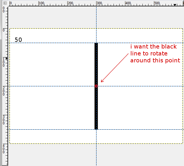

noob question:
so i downloaded the 'script-fu-copy-rotate' and it took me really long to figure out, where it is acutally located in the menu
was expecting this to be under Script-Fu or maybe Rotate, but it is in the Selection menu..... :|
next i tried to rotate a line but it makes really weird things out of it, and i cant see what the logic is behind these actions
so what do you actually enter in the center x/y coordinates field ?
lets say my canvas is 600x400, that would make the center at 300x200, right
but apparently that is not the point this script uses as the center of rotation
halp ? :(
btw: dont these scripts come with some sort of manual ???

300 by 200 should be correct. Why did you not use a square canvas?
 Post subject: Re: Metal Wurx - Part XIX Indicator Lights
PostPosted: Tue Jul 31, 2012 6:28 pm  (#13)
Joined: Jul 17, 2012
Posts: 2769
because it was just an experiment how the script works
after that i followed the instructions of this tut and the rotating worked okay
does this script only work with square canvas ??

Hi Drac, Great Tutorial. Thank you. Here is my result. I added one extra combination with the ribbing on the inside. I flipped the 90% reduced ribbed layer horizontally and vertically before merging with the bevelled layer so that I had a bevelled inner ribbed layer (lowest right) as well as your inner ribbed layer which looks flat. I only show a brass overlay on one bezel.
