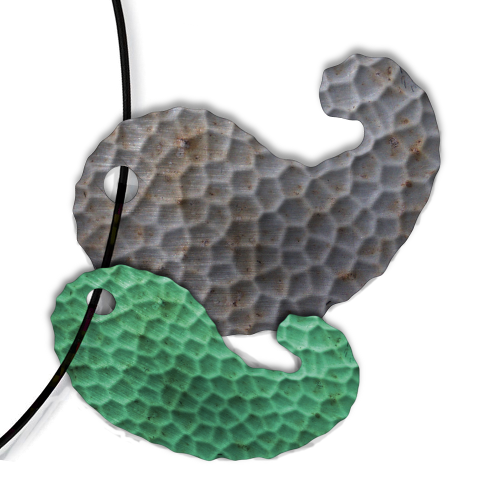

draconian, you're now officially my hero! great tutorial, i had to fight a bit with the voronoi filter but i made it and your hammered metal effect looks perfect! i've done this for real a lot, so i'm a bit fussy with the result. here's my new necklace in steel, anodized titanium (my favourite metal technique irl) and leather cord.
i should of course have resized and rotated the titanium paisley before i added the hammered effect, but you live, you learn :) .
:rofl Thank you! I don't know if I want to be on a pedestal that High up, I'm scared of heights. Glad you liked it.
