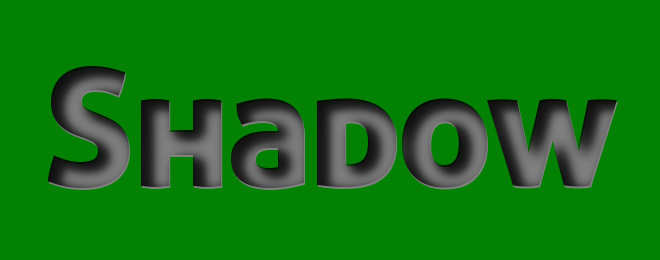

Here you can see the same Inner Shadow but with an Offset of 6/8:
If you want a very dark Inner Shadow, duplicating the layer can sometimes be a good idea. Like this:

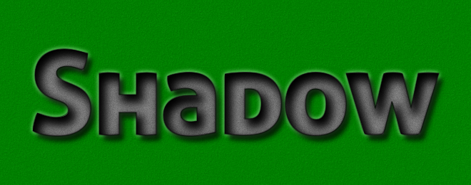

To make our final example a bit more interesting, i added a dropshadow, an outer glow and a stroke.
The text layer got noise and the background a bit of bumpmapping.
