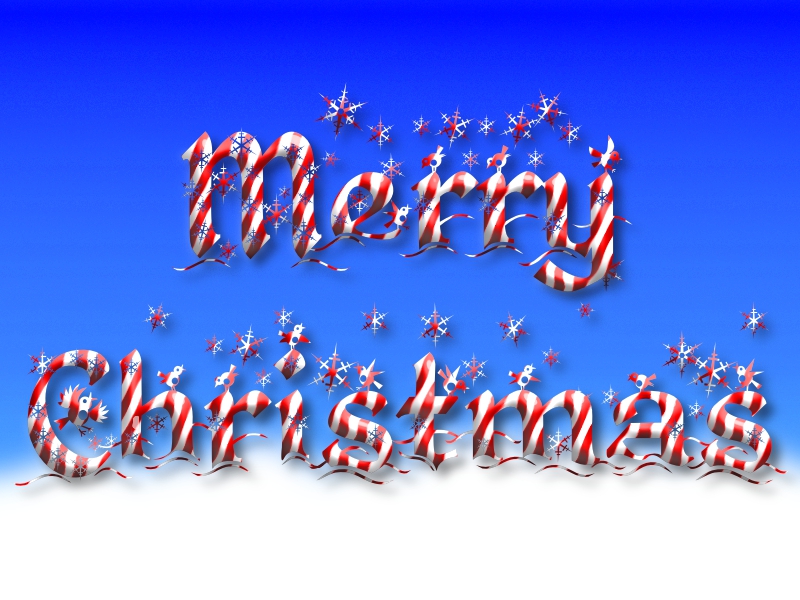

I love the tutorial. I wasn't sure which layer some of the steps were done on, but I think I figured it out.
~and~

Molly, tell me where you're not understanding the steps - and I'll try to clarify. The author got ahead of himself in several steps of the tutorial, and his illustrations are usually a step or two behind the actual steps. One key area that stumped me (and I later figured out, was that after you duplicate the text layer 3 times - 1) you'll add threshold settings to all 3 layers, 2) you'll use Color to Alpha on all 3 layers, with the target color as black, 3) then blur all 3 layers. 4) just slightly use colors - curves on all 3 layers.
One thing the step failed to mention (or I failed to notice) is that after you lock the transparency with the initial blur in the beginning steps, you need to unlock the transparency before you duplicate the layer 3 times, otherwise your blurs on the highlights will do nothing at all, at least til you unlock them (if they are locked).
If I had more time, I'd re-do the entire tutorial, but in the meantime, let me know where you're getting hung up exactly and I'll help.
