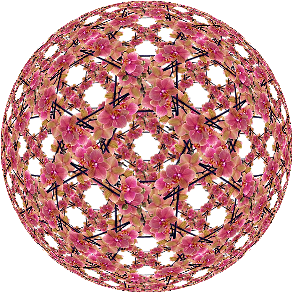

I actually discovered this trick yesterday; much better result then my previous results that I sort of eluded to on an earlier thread. So easy, in fact, that I'm actually going to share a quick tut with you all (as lazy as I am; lol).
requirements:
1) A seamless texture, preferably one with a lattice structure. Used this one for the example.
2) Mathmap
First, duplicate your texture and then run Small Tile (set to 2) on the top layer and Small Tile (set to 5) on the bottom layer (sort of a skipped Fibonacci sequence; lol).
Now defocus and darken base layer (assuming you can figure this one out) {see attached image for my result}.
Image hosted free thanks to ImageShack (http://www.imageshack.us).
Now run Lens Distortion {again, see attachment for the settings that was used}.
Now run Autocrop which is under Image dropdown menu.
Finally, run Mathmap's Distortion>Sphere (the best Sphere method that I've seen; use this one almost exclusively now) {see attachment settings that was used}.
Done (well, I did went ahead and sharpened this result some before posting it here). :)

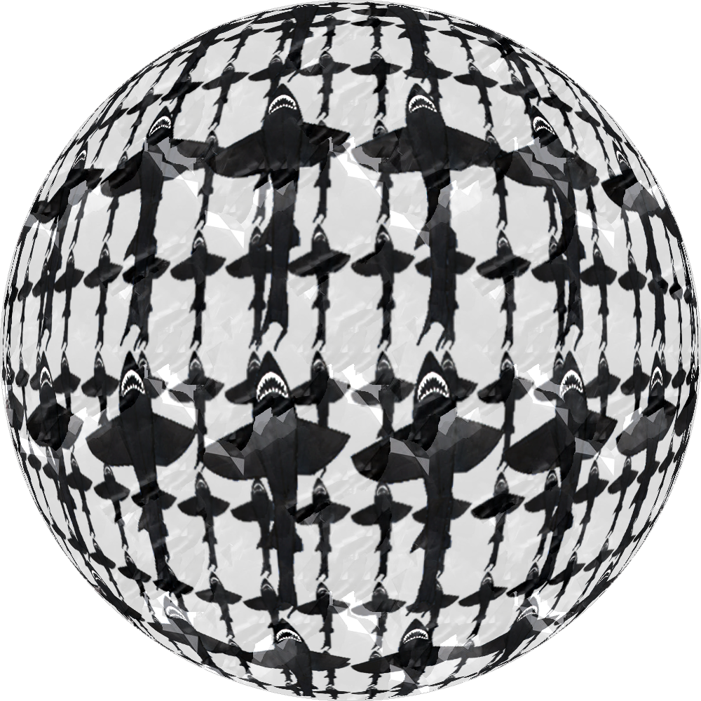

Dot textures work too O; just need to add a glass effect imo. :)
ref: http://www.fontplay.com/freephotos/four ... 08a-31.jpg

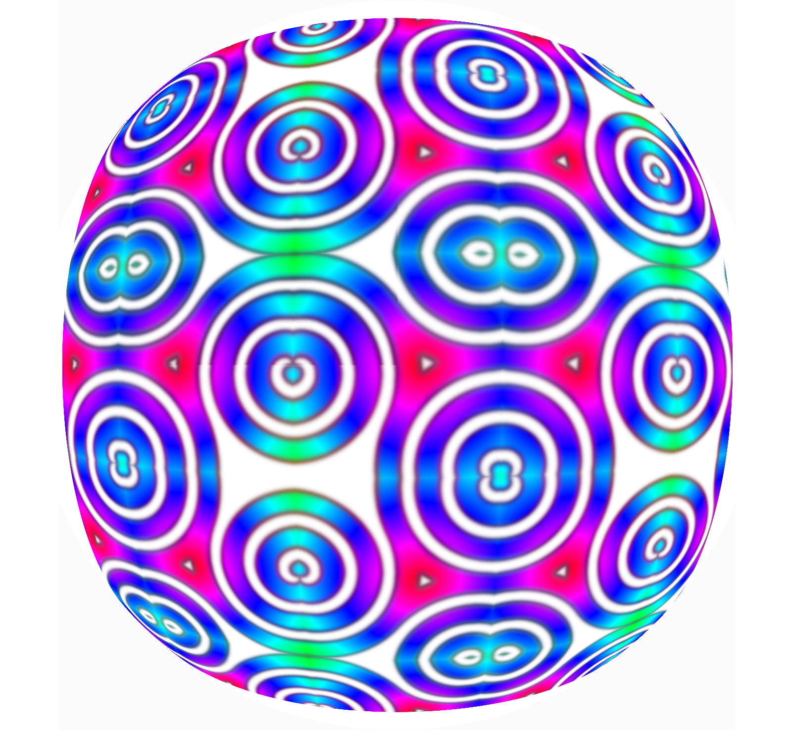

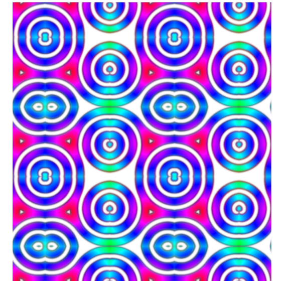

Anyway you will remember my "rainbow" triple spiral download/file.php?id=446 well this is what that filter did
and tile so well
So back in theme i ended with a sort of sphere..hem..a very squared sort of half sphere since is semitransparent is easy see has no a backside but...
