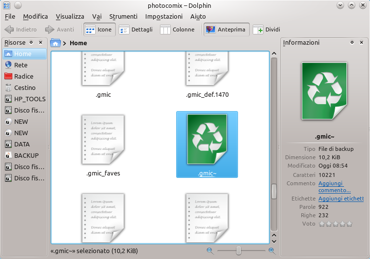

Do you use Fedora, correct ?
Works for Frdora as any other Linux flavour: look the screenshoot of my Home directory
Do you see the file called .gmic ?
OOPSS not the green one , the other on the top left
That is it:
paste the code in a text editor save as .gmic (note the dot before the name)
That just for the first time, if you wish add more codes, you may just open your gmic file and past how much new codes you wish separate by a blanck space
Almost the same for XP the only difference is that in case the place is C:\Documents and Settings\Your name\Application Data
here the screenshot
In xp the Application Data is a hidden folder, but to see it is just needed to go in the file browser preference >Option for file and folder>
and there check "Show system and hidden files"
I can't help for 7 because i seldom use 7 , but even there should be not difficult find the right folder;
it is the same where is a gmic_def.1470 file
Last for Windows user: to save a file with the name starting with a dot,
the easiest way is get notepad++ that is also a excellent replacement for the MS notepad
So it is really easy...maybe even easier then install a script fu :yes

I don't have a folder named .gmic anywhere on my hard drive. I looked in my home folder and none there, then did a complete search of my hard drive ... nope.
I have the gmic plugin in .gimp-2.6 / plug-ins
 Post subject: Re: (how to emulate ) Ink Wash
PostPosted: Tue Dec 28, 2010 1:26 pm  (#7)
You should save the code as .gmic = you should create a .gmic file (NOT a folder !!) in your home directory.
After you have saved the first code, i mean once you create that .gmic file, you may paste on the same file (again same file , should NOT be a folder) more codes , just separated by a blanc line.
In linux all files and folders with name starting with a dot are as default invisible
But in the View menu of your file browser there is the option "show hidden files".
so is really simple.... literally save the code as .gmic in your home directory
(again do NOT save as Ink Wash.gmic or something similar...save simply as .gmic)

Sure ! just require the last gmic version (gmic is updated very often, last version has about a week )
i don't know where is the gmic_def.1470 file on MAC,(it is a file created at the first filter update ) but i suppose you may use the Finder to find it
Done that is sufficent paste the code on a text editor and save the file as .gmic
save a file as .gmic is so simple so easy...that everybody get confused, expecting something much more complex
see the messages before this in this topic to see how, in case you have doubts
