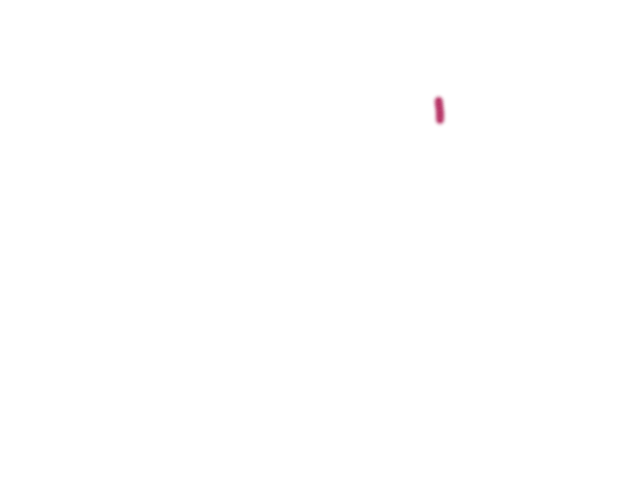

In combination with "Simple path shapes" I got this one as (simple) example:

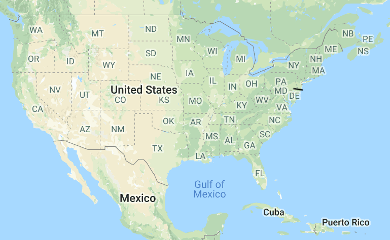

Never knew about this one. It would make a good map route animation. Yes, it works fine in Gimp 2.10x.
