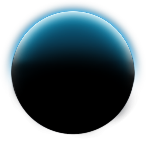

There is a Planet Render script,
which can create a planet like spherical render seen in the image below.
It can be used as a good base to create a planet from.
File comment: Planet Render Script Example Image
This image here,
is a planet I made using this script.
The link below is to The Plug-in Registry and the Planet Render Script.
http://registry.gimp.org/node/21
