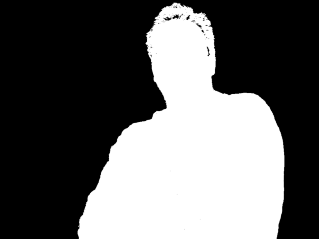

Joined: Jul 04, 2011
Posts: 395
Location: Indianapolis, IN
Thanks mahvin!
Although I may have made 'me' just a bit to white. Hardest part was defining the bold black background since the background was really dark to start with. But I accomplished what I set out for!
On a side question is that pencil sketch of you a filter/plugin or was it drawn? I an see a signature in the lower right corner so I'm guessing drawn. I was trying to pencil sketch myself but I just really don't like the results.

Your entire body should be white, your background black, because a mask basically says, "show me everything white, and make everything black, transparent" this way you can change the entire background behind you, with ease.
