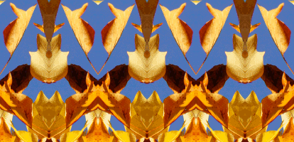

This script
sliding-horizontal-kaleidoscope.scm [3.43 KiB]
Downloaded 248 times
located at "<Image>/Filters/Animation/Sliding kaleidoscope"
is a .scm file, that when run on an image will create a sliding horizontal kaleidoscope animation, as seen in the example shown in the following post
To create an image to use the script on
1. Choose or create your initial image, the pixel width MUST be a multiple of 6, in the example below 138 wide x 200 height (height doesn’t matter)
138x200.tif
2. Copy and paste this initial image 3 times into a second image that is 3 times the width, as seen below
138x200x3.tif
3. Run the script on this second image, it takes a couple of minutes on the example above
4. Save as a .gif file or play in the Filters > Animation > Playback
Notes:
The number of layers created is equal to (the pixel width of the image divided by 3) - 1, so bigger images take much longer for the script to run with file byte size increasing massively
The script should really do step 2 for the user and should create the gif as a new image, sorry it doesn’t, my bad
If it crashes other than the image size not being a multiple of 6 I’d be grateful to know
Steve
 Post subject: Re: A sliding horizontal kaleidoscope script
PostPosted: Sat Dec 24, 2016 5:25 am  (#2)
Joined: Dec 26, 2014
Posts: 205

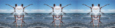

PostPosted: Tue Dec 27, 2016 2:27 am  (#5)
Posts: 14204
Steve, thank you so much for your nice script to play. I like it a lot. :tyspin :coolthup
PostPosted: Tue Dec 27, 2016 5:52 pm  (#6)
Posts: 205
:tyspin Issabella
Your ballerina works well with the sea and sky background :bigthup
