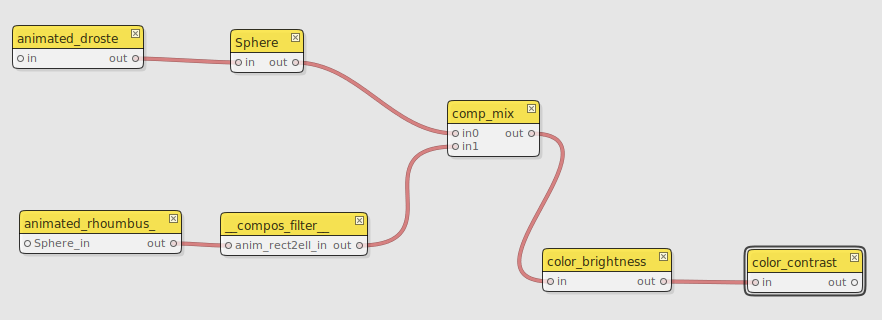

Hi guys, I'm glad you liked this one. AnMal said
You put down a lot of work on that one, didn't you?
Actually no.
I discovered how to automate the process.
The 'comp_mix' box is like a sound mixer except it works with images.
I used MathMap Composer which was first demonstrated 8 to 10 years ago with still images. But hardly anybody tried it with animation.
Maybe their computers were not powerful enough back then?
Composer combines all the elements into one page of sliders and options. You have as much time as you like to get the effects you want.
It's just like using a music synthesizer! When happy apply to multiple layers and you have an animation.
I've found there are other mixers including ones with double feedback and I haven't yet tried the many filters with animation.
Disclaimer. I'm the current maintainer of Mathmap but most of the C code is beyond me. I stumbled on this process after watching an old video by the MathMap coder Mark Probst.
