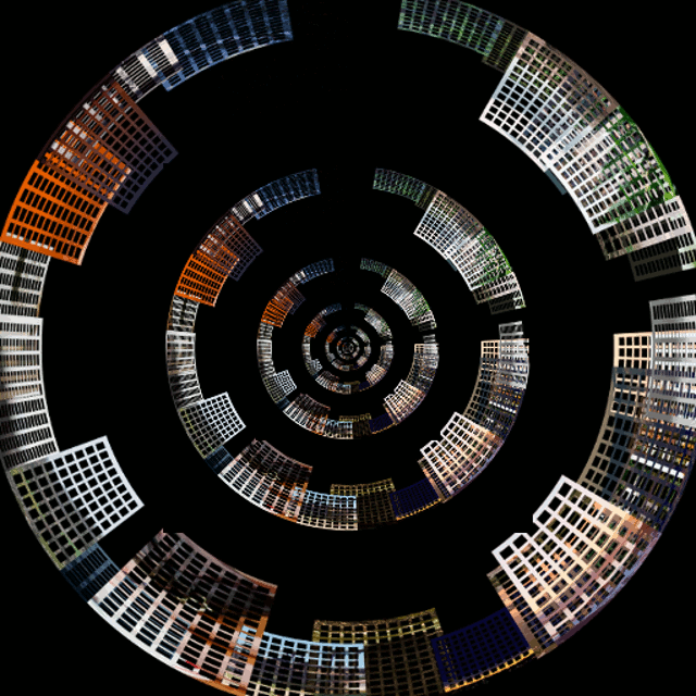

I wanted to see if I could make an 'infinite zoom' in Gimp.
I figured out a method but haven't perfected it yet so sorry.
First I used Filters>Map>Recursive Transform - it's fun to learn to use.
Then I used G'MIC >Deformations>Zoom to zoom into the recursive transform by a set amount. What happens is the pixels get progressively bigger.
My solution is to paste and scale the original layer into each version of the on stage screen. There are less than 20 Gimp frames and this always makes a clear image. The paste and scale is not very scientific and there is human error because the frame can get vague.

Hi Nidhogg and racer. You guys can understand these are not too easy to make.
I improved the technique. Still using Recursive Transform and G'MIC Zoom. Now I duplicated the bottom layer and added 0.05 zoom to each subsequent layer. There are 26 layers in this but I doubled them to get a better speed.

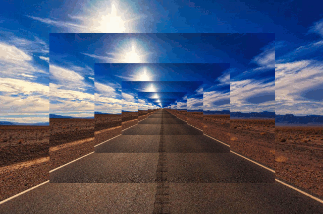

That one looks better. I just found out you can do it all in G'mic using Droste and Zoom. Here is a quick 4-frame animation. I used reversed zoom, then reversed layer order. This reduces blur.

PostPosted: Wed Jul 01, 2020 2:52 am  (#7)
Joined: Dec 26, 2014
Posts: 205
A neat effect Tas_mania
Perhaps the rocking motion adds to the effect. To me it gives a sense of hurtling through the scene, while a smoother scene would give a sense of the viewer being static as the scene passed around them
I was intrigued how these were made and had a try at scripting the effect, got a script up and running but still needs a couple of niggles ironing out
steve

 Post subject: Re: My First Infinite Zoom In Gimp
PostPosted: Wed Jul 01, 2020 4:05 am  (#8)
Posts: 1442
Cool animations guys, infinite zoom suits well for space travel.
Excited about your script Steve, tried manually but it didn't work.

Pretty sure racer-x is using Droste Frames rather than Continuous Droste. (Not sure what 'reverse zoom is' :)
It gives a very smooth zoom.
Hi Steve, I agree with Nidhogg, a script would be very nice.......but not easy.
The zoom center must be in the center of the canvas.
My zooms and Steve's produce a slight 'pulsing' effect. I don't think it's an optical illusion. I suspect it's mathematical. More frames = more loss of resolution. Needs investigating. :)

Yes, I used G'mic > Frames > Droste. Reverse Zoom is done entering negative numbers so you are zooming out. There is no blurring of quality this way because the image is downscaled vs upscaled.

Posts: 205
That pulsing effect is the last niggle I can't remove, I think its something to do with a 2D screen trying to get a 3D effect, its more noticeable on some images than others
It seems I can't upload .py files to gimpchat and I've lost the ability to put files into a zipped folder so I've made a post on gimplearn, sorry about this
script on gimplean at
https://gimplearn.net/viewtopic.php?f=3&t=2738

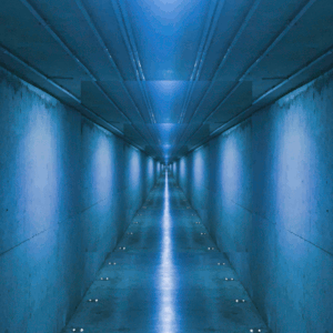

The pulse is still visible, but I tried to fix it by changing the duration of first few frames.

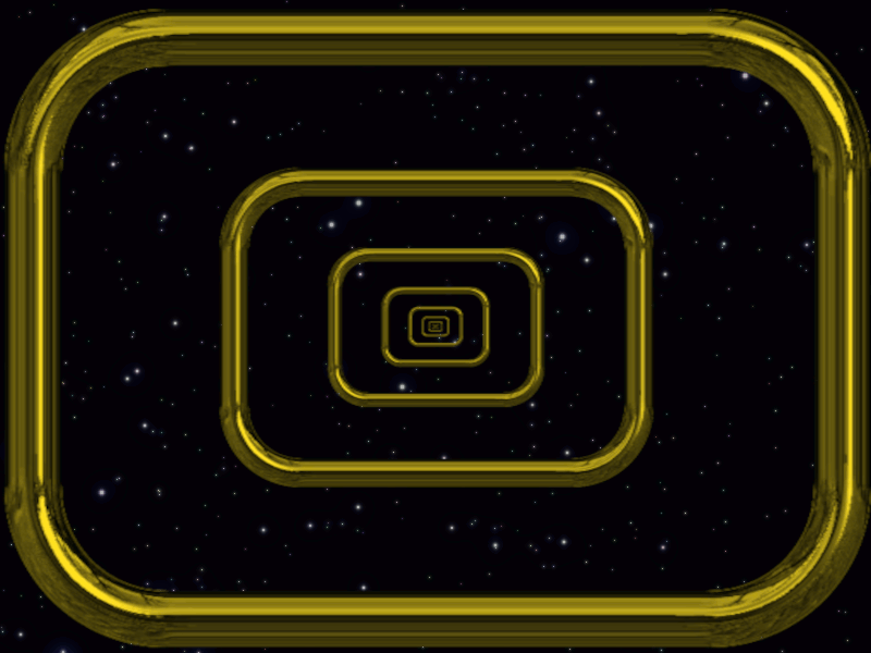

Thank's Steve, this makes it super easy. Tested with 16 frames set @ 60 ms. I'm running the same as Nidhogg.

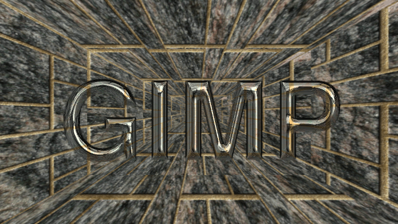

G'mic has a frame filter called "Cube" and I used it to make a tunnel out of a stone texture that I made. It looks cool in this animation and I even managed to make the wall reflection on the chrome text. :bigthup

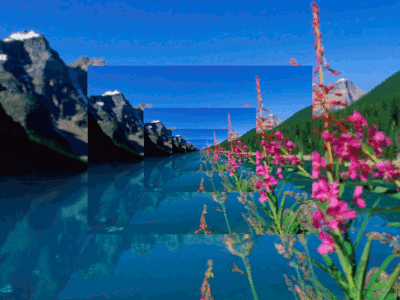

Joined: Nov 22, 2018
Posts: 83
Its a long paddle to the end of the lake..... :hehe ...
Many thanks Steve, you made life a lot easier....

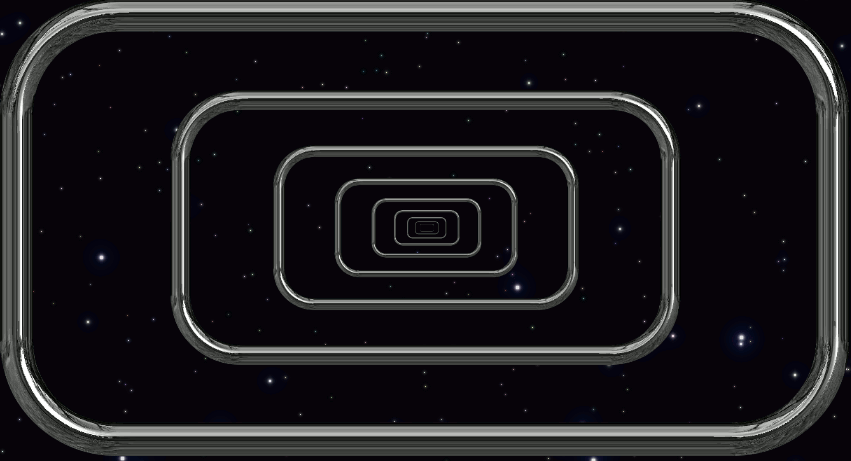

I did this manually only 13 frames.
Hey racer, very nice brick animation. Where do you enter negative numbers? Can't do it in G'MIC Zoom or Droste Frames

Thanks Nidhogg, happy to see there were no problems. Good call on changing the timings of the frames to lessen the pulse effect, will look into this today
Thanks for testing racer-x, kicking myself now, wishing like your image I'd added a starry background
Brilliant image Wallace, it makes me laugh
Cool image FlutteringBy, keep paddling
