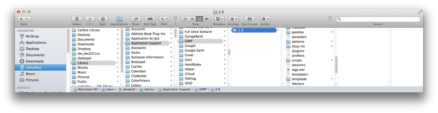

ok I have successfully added G'mic 1.5.8.2 to my GIMP.
Here is what you need to do.
1. Open the Macgmic package. you will see several items in there. You only need to use the item labelled gmic_gimp.
2. Navigate to users/library/application support/gimp/plug-ins and add gmic_gimp to plug-in folder
3. Restart your GIMP.
I'm pretty certain that this will give you the newer version, as it worked for me.
Hope this helps everyone.

path for adding gmic
