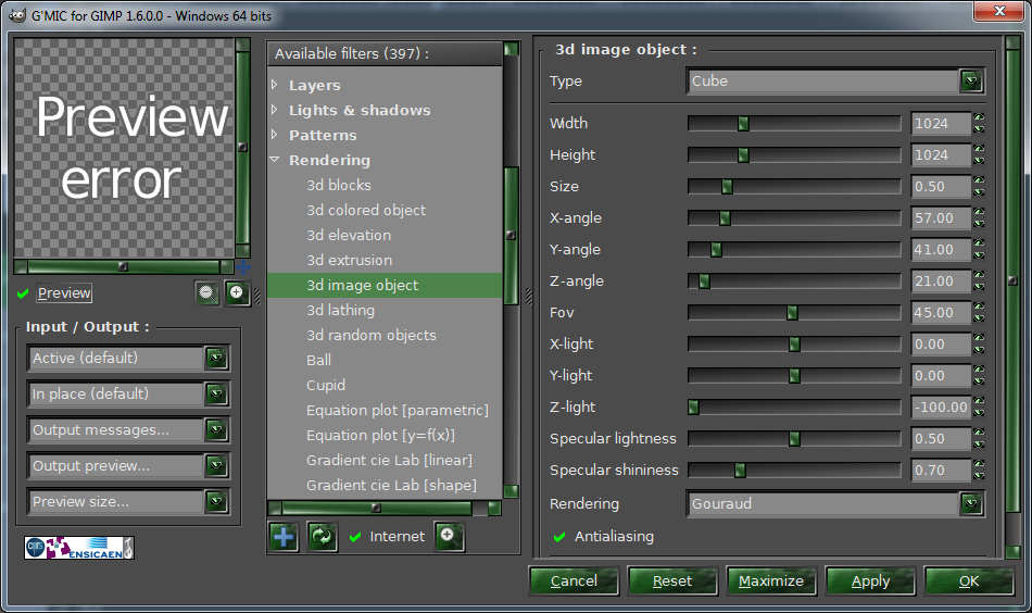

Thanks Graechan to pointing this out to me.
I've added a 'Antialiasing' option that should improve the rendering. Could you 'refresh' your filters and tell me if that works for you ?

PostPosted: Mon Sep 01, 2014 3:16 am  (#3)
I had the option when I refreshed but it had no display and didn't work so I refreshed again and the new option had gone
but it still didn't have a display or work
There are other scripts that use imageoblect3d will adding a new option affect them

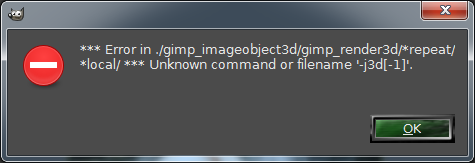

This morning I refreshed Gmic and now it's broken, has anyone else got this problem

I also get this error

I refreshed when David was sill working on the antialiasing option, as at first he tried it with (options 2x,3x,4x etc) which failed and corrupted my Gmic
no worries, I reinstalled Gmic and all is OK, Wow what an improvement :jumpclap

Graechan, you were probably working with a beta version, the command -j3d had been added few days before the final release.
Happy to see it works for you now.
