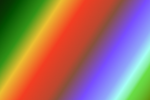

the result is an image with bands of pure (255) colors:

1-it seems that the execution part of the command only gets from the max fn a value 0,0,1 or 0,1,0 or 1,0,0 for the channels, so that the multiplier 255 transforms them into 0,0,255 or 0,255,0 or 255,0,0
2-if I replace 255*(i==max(R,G,B)) with (i=max(R,G,B)) it seems I get the correct max values but in greyscale
(strarting from this original)
hope this infos can help you...

R=i(x,y,z,0);G=i(x,y,z,1);B=i(x,y,z,2);M=max(R,G,B);M*(i==M)
Should work then.
