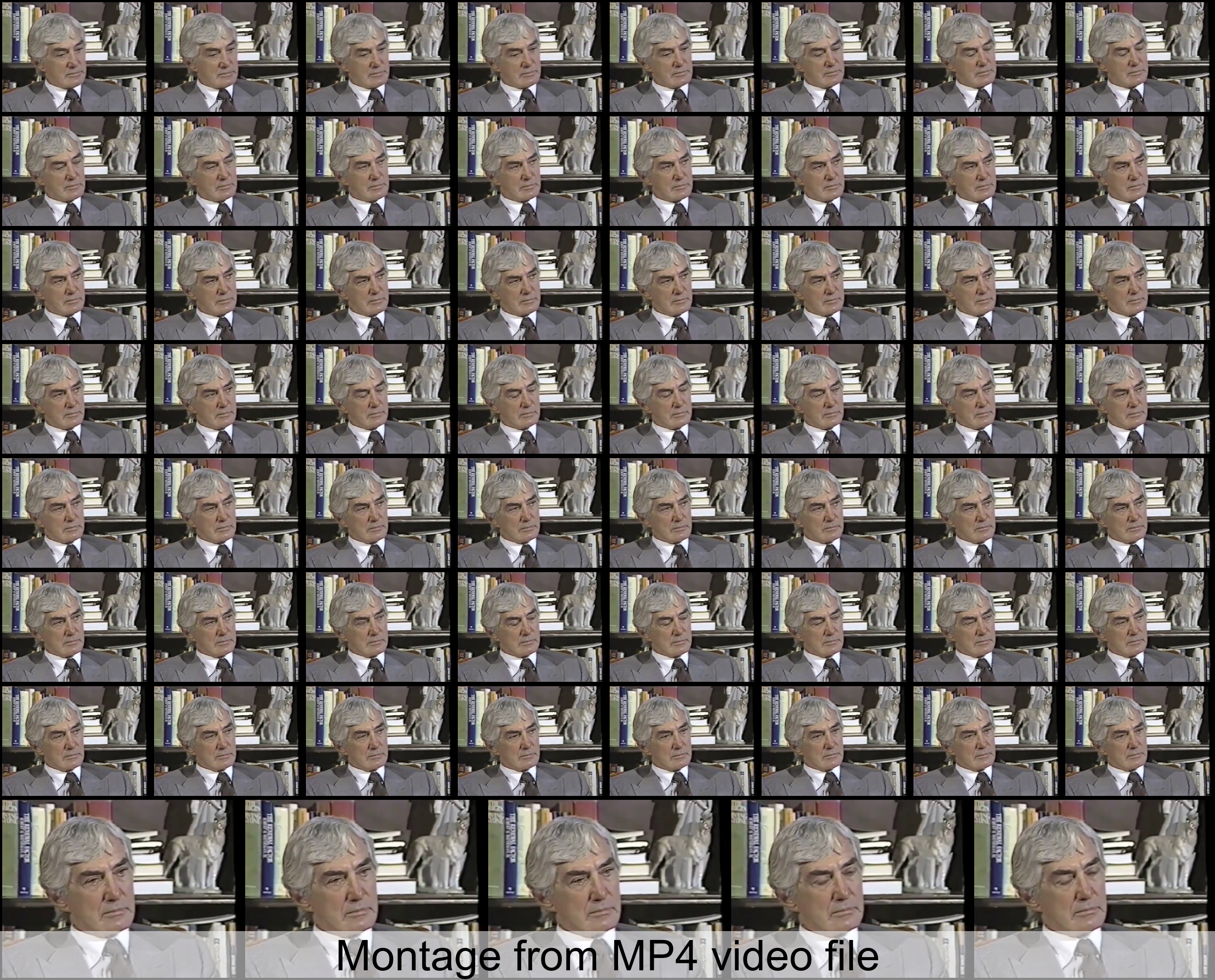

Here's the Thunar Custom Action to create a contact sheet from a video, with 1 frame every second:
gmic %N -keep[0--1:24] -gimp_montage 4,\""V(H(0,1),H(2,V(3,4)))"\",1,1.0,0,5,0,0,0,255,0,0,0,0 -o -0000capture.jpg
I can modify this at some point to work with YAD or Zenity, so a box pops up asking for a custom frame capture.

@serche : the problem with your latest command (for the videos) is that G'MIC first loads all video frames in memory, and then discard 23/24 of them, which is not really optimal in term of memory consumption.
You should instead load only 1/24 frames of the video files, like this :
gmic %N,0,-1,24 -gimp_montage 4,\"\",1,1.0,0,5,0,0,0,255,0,0,0,0 -o -0000capture.jpg
EDIT: I've just discovered a bug that causes G'MIC to hand if the video does not have a number of frames which is a multiple of 24. I've found a fix, but I need to release new binaries to make it working for everyone.
EDIT2: I've build new beta packages with the fix included, available on the G'MIC sourceforge file server : https://sourceforge.net/projects/gmic/files/beta/
Tx for the improved command! I'll update G'mic. When I open terminal in the folder do I install it the normal way, i.e.:
.configure
make
make install
 Post subject: Re: G'Mic montage from Command Line returning errors
PostPosted: Tue Mar 10, 2015 4:15 am  (#19)
Joined: Jan 03, 2011
Posts: 1656
serche, there is no 'configure' in the G'MIC package. I just use a Makefile, so go to 'gmic/src/' and type 'make' and it should compile,
unless you have missing dependencies. Those dependencies can be found usually in your package manager.
