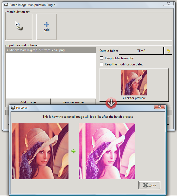

What kind of system and versions?
For me to Win (Gimp 2.8.16 and BIMP 1.6) are working properly.
Is the preview mode (single picture *.jpg or *.png) you have a good result?
For example (film_60's):
-gimp_emulate_film_various_preview 1,1,0,1,0,0,0,0,0
- whether with this code also an error?
