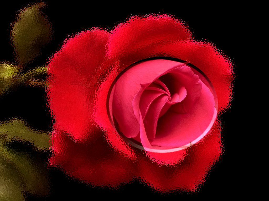

 Post subject: Re: Textured Glass
PostPosted: Wed Mar 23, 2016 1:26 am  (#6)
here it is

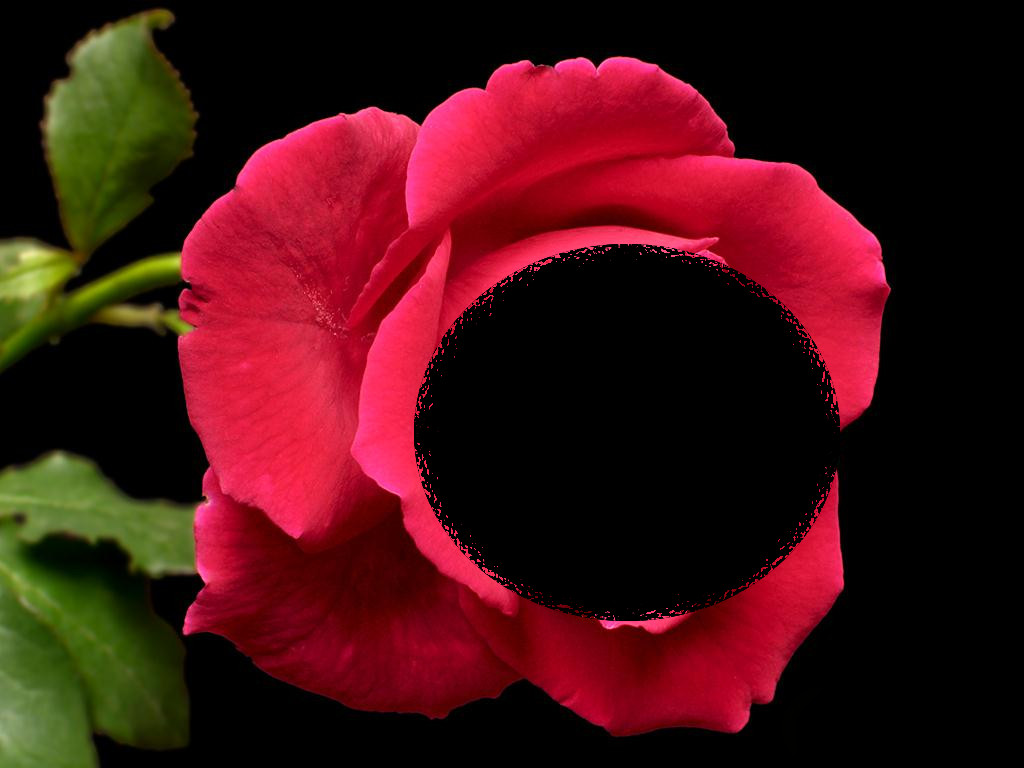

PostPosted: Wed Mar 23, 2016 1:39 am  (#7)
A (probably useless) warning: the filter DOES NOT TEXTURIZE A TOTALLY TRANSPARENT AREA.
Thus, if you make a selection and the current selection is the transparent area, not texturize occurs
the centre is shown black but it's a transparent area selected

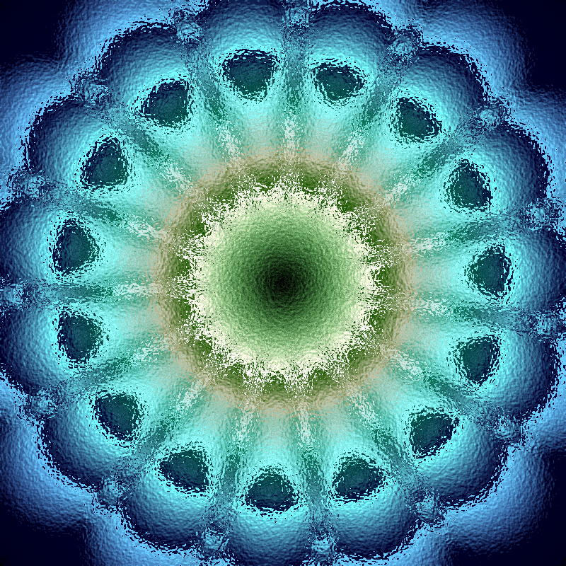

PostPosted: Wed Mar 23, 2016 3:13 am  (#12)
Posts: 8457
MORE IN GENERAL: THE FILTER DOES NOT GENERATE A TEXTURIZED PATTERN ON ANY FULLY UNIFORM BASE;
was this the case, Sallyanne? did you try to texturize a uniformely coloured area?
I tried it on the blue/green image after I overlayed with a transparent layer, coloured with a gradient and reduced opacity. It generated but didn't save.
PostPosted: Wed Mar 23, 2016 3:35 am  (#13)
Posts: 8457
Flattened the image and it worked
