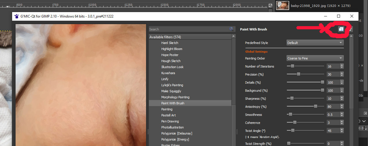

OMG:
- there is a "copy" command (look at "CopyHere" attached); click on that icon
- then edit layer "attribute" and "paste" (look at "PasteHere" attached)

Teapot - thanks for the reminder, yes that is the same issue.
Diego - thank you very much; that is a solution, not as quick/easy as before but a solution. Thank you again.

The reasoning behind the change is at the end of this
https://discuss.pixls.us/t/solved-putti ... es/29628/5
Personally, I hated the over-long layer names, some of the gmic parameter strings are quite long.
A bit tedious but you can still copy/paste into a layer name or depending on work flow paste into Gimp Image Comments for use later.
