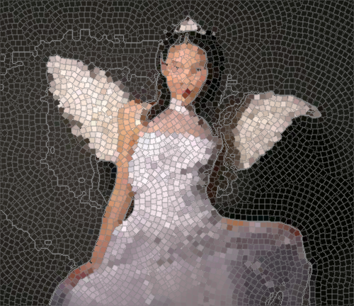

PostPosted: Thu Dec 18, 2014 9:26 am  (#11)
just to understand what we are talking about:
mosaic by G'MIC mosaic (currently available)
opus-vermiculatum
opus-musivum
