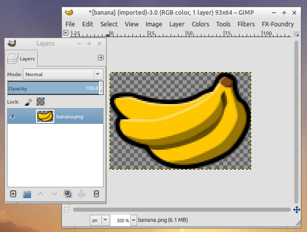

Here is a quick description on how it works :
- First, load a simple shape (a small image with transparency), like this :
- Then, open the G'MIC plug-in, refresh your filters if you haven't done it yet, and go to 'Patterns / Pack shape' :
- Let 'Masking' parameter to 'No masking', set your rendering width and height, the number of different scale, etc... then click OK. You'll get this (note that this filter has an accurate progress bar, as it takes some time to compute) :
