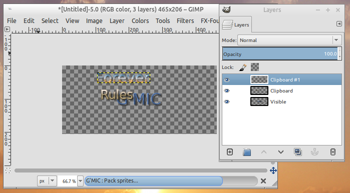

I've updated the G'MIC filter 'Patterns / Pack Sprites', and it is now able to pack multiple sprites on the same image. Each sprite much be located on a different layer. You can also add a bottom layer for additional masking (as before).
Here is an example. You can start with three different layers, here containing some text :

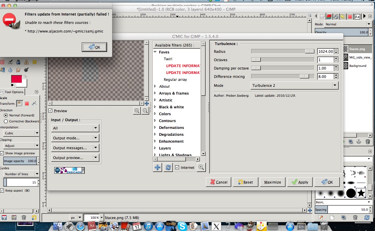

I have updated several times but it has partial failure...samj...and pack sprites is not there under patterns????
*adding screen shot ...

2-ton, you need at least version 1.5.6.0+ of the G'MIC plug-in to get the updates.
You should consider updating it as soon as possible.
